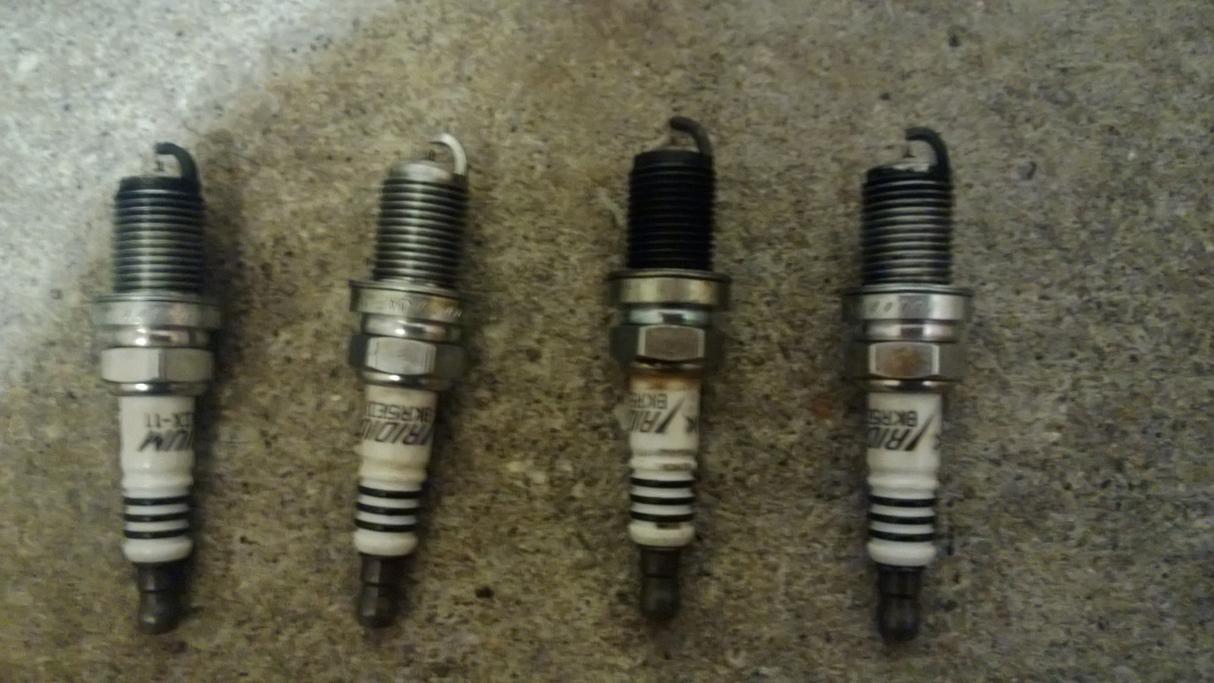

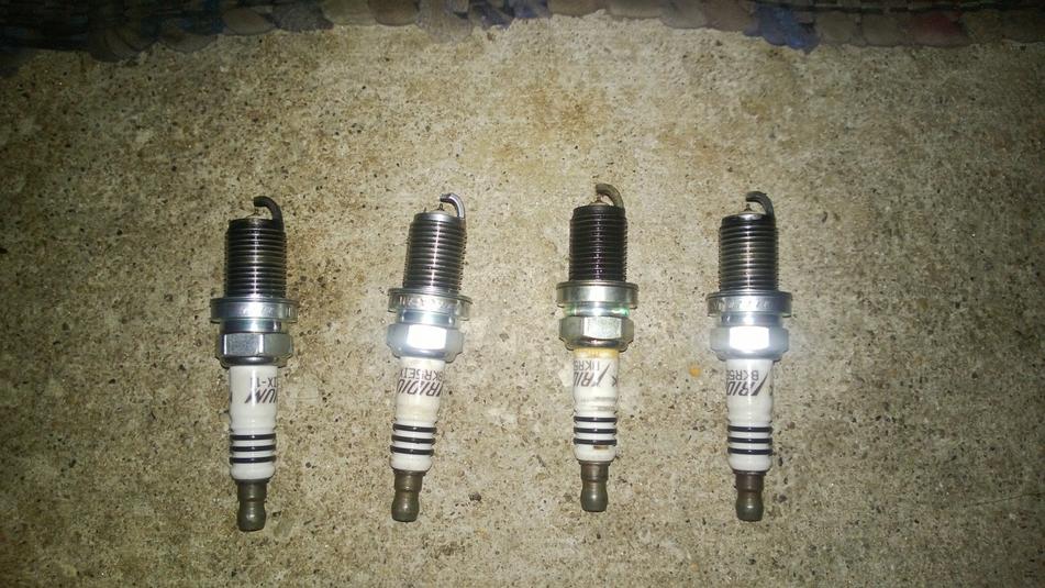

I did pull the plugs and you can see from the pic, cylinder #2 looks like new while the other 3 have some carbon build up on them. Anything else you can guys can gather from this? The gaps are fine...all 4 plugs are at 0.041
I swapped a coil out but still no better, so I am leaning toward injectors. I will try out my old 4 injectors from the original motor.
Also, the power loss is most from a dead stop and up hill...once I get going, the car does accelerate but it is severe power loss and very slow acceleration.
However the tranny seems to be shifting fine so I am quite certain its just a really bad misfire. The cats are no longer glowing red so I am getting closer.
Question, my old coil packs are quite old...one is original (230K) and the other much newer, had to replace it due to a stripped bolt. The ones from the junkyard engine have like 70K miles. Should I just buy 2 new coils? My wires are the aftermarket magnecor wires.
