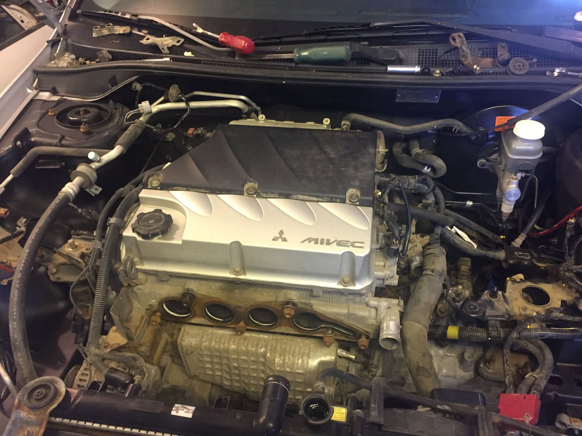

Doing the swap right now in my 03 Es

The fastest and easiest way to do this swap.... jack the car up high enough, pull the fender liner out, take the windshield washer bottle out. With the rad and ac condenser out. If you have pulled the axles, take the cross brace off with the lower trans mount (rad side), remove the mount through bolt (firewall side) lower the engine and trans together on the ground. Then drag it out the passenger side through the huge opening. I dropped the 4G94, fully dressed and pulled it out, then slid the fully dressed 4G69 in its place, hoisted it up together and put the mounts on. Probably one of the easiest conversion swaps I've ever done.

it was so much nicer pulling it up into place and not messing around with the "power supply" wiring as I disconnected it from the engine fuse box and left it with the motor. With all the accessories and belt on, far less work to do when the powertrain is in place. I have the exhaust left to run, this evening, and she'll be up and running.
granted is did a bunch of "pre" wiring and things before putting the 4G69 into place.. I modified my ralliart harness and took the entirety of the ABS system out of the harness. Just for the cleaner look.

As of this evening my 4G69 swap into my 03 Es, is now a running unit. Fully wired and did the test start up, loud as hell as I have no exhaust on it. Just wanted to see if it fired. I'll have the exhaust and put it in on the weekend. In the meantime, I'll put the rest of the car back together and by Sunday I'll be driving.

4G69 swap complete and running. Up to operating temp with zero issues. Reassemble the front of the car and go driving, is all that's left.
