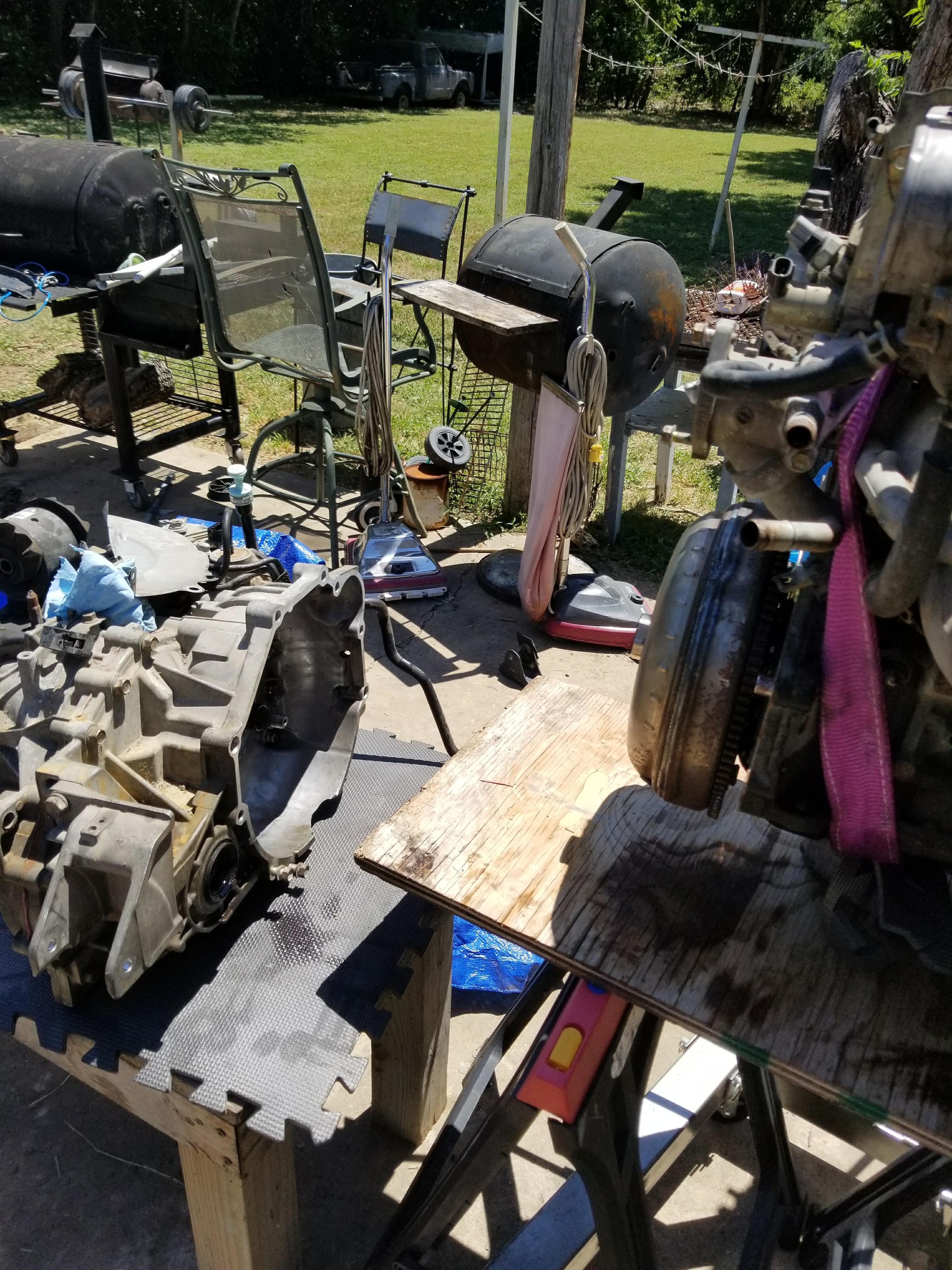

We can't get this to slide all the way over onto the engine. It goes so much then one slide all the way over. Thisbis very frustrating in the Texas heat. Any advice or thoughts would be helpful.

Because something is missing. The torque converter! It has to be inserted into the transmission and seated into the oil pump.

Yeah, we finally looked up some videos and turned the torque converter on to the shaft coming out of the transmission. The next issue we were having was trying to remove the nut on the inside of the firewall of the ralliart.
