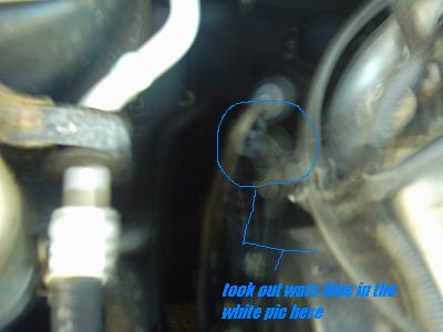

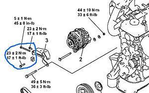

ok sis anyone change there alternator belts i need some tips

Originally Posted by rhyzin
i thought you did this last nite?
lol i tried too... but ill try agen today...well uhhh we took out the parts that circled in blue... but we still cant get the alternator or whatever thats soopose to pivot....
any way heres pics what i just did last night be4 it got to dark..
