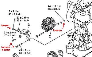

rhyzin... i still cant get the alternator to pivot.....

this should be it

ok ive done the alternator belt..... so those of you who needs to replace this belt that pic above will help u out... thanx to rhyzin

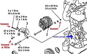

Oh, and rhyzin, can you change the water pump without taking off the timing belt?
Old Dec 23, 2005 | 11:08 AM
comatose721's Avatar
iTrader: (16)
Posts: 1,425
From: Toms River, NJ
timing belt is a must. it all has to come off. i edited rhyzin's picture for you so you can see the water pump more easily

Thx a lot comatose721!
I guess it's another project for 2006.
