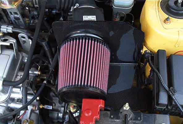

rrm uses a k&n filter, comes with a carbon fiber heat shield too

this is the one i got from rrm. sounds nice! i think it has a great price too.

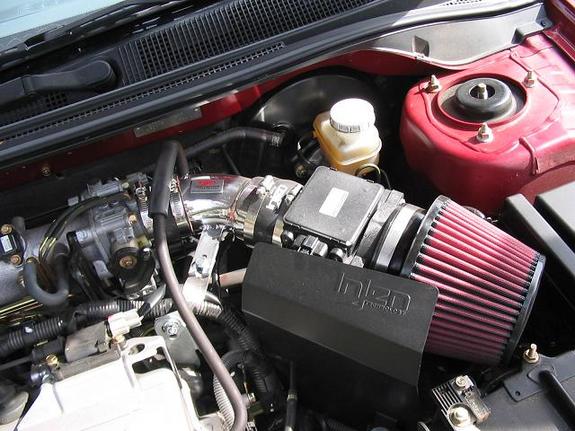

You should get the injen intake. The RRM intake is simply a filter and an adapter plate, thats why I dont like it. The injen, however, actually replaces the entire stock intake system from the throttle body down. Plus it sound cool and has a big increase in power.
Heres my intake:
