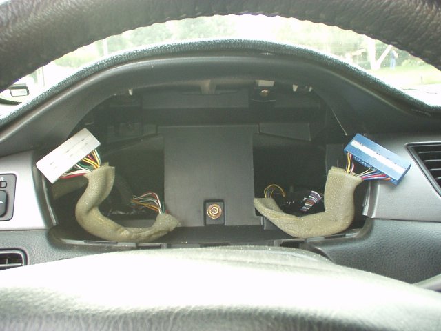

es, ls, and oz i are the exact same (electrically speaking)
the only difference is the way the gauges are physically represented in front of you.
if you wanted to do the swap, all you would need is the gauge cluster. its not mechanical, so it unplugs real easly from the wiring harness.

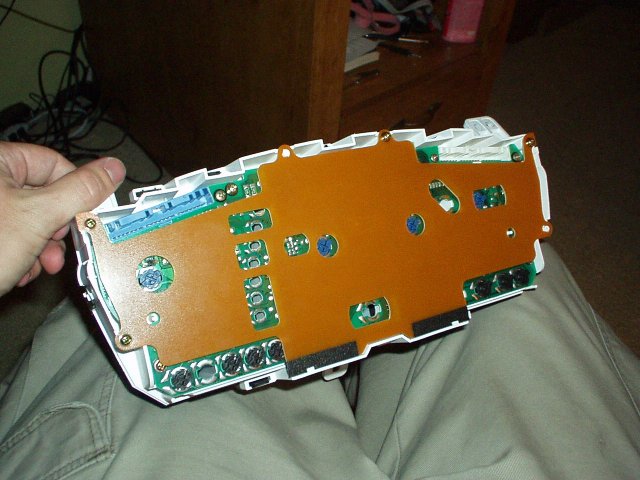

back of a es gauge cluster, notice theblue circles thoes are the BULBS FOR THE COLOR OF THE GAUGES. so now everyone knows
Link

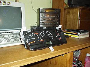

front of a es cluster
Link

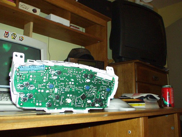

here the back of the OZ cluster, once again the blue circles are the colored bulbs.
(dont you like information overkill?)
Link

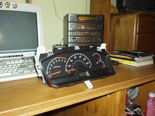

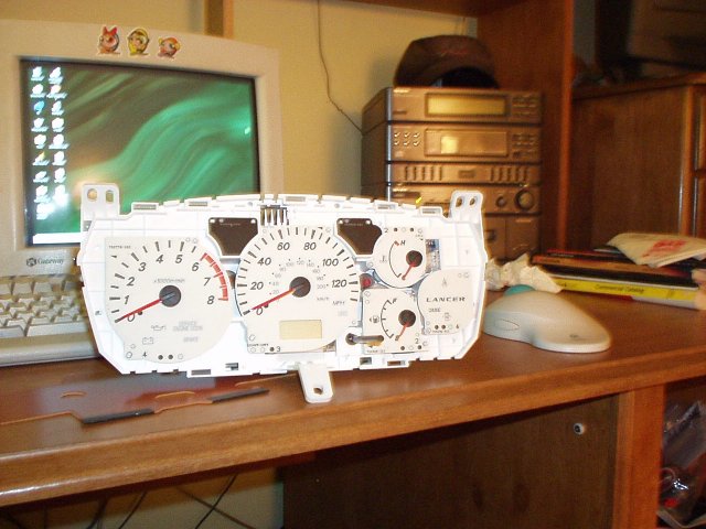

the front of the oz cluster
you would have to replace the ENTIRE cluster.
im not sure about a price, sorry,
hope this help thoes who have questions
