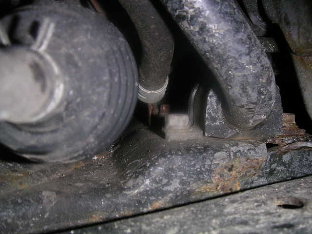

Blurry picture of stock location (on top of a cross-member, near rear motor mount)
Better picture of stock location (passenger side)

Not many pictures, but here we go.
Remove the bolts and pull off the bracket. Slide out stock bushing and slide in Deyeme bushing.
Replace bracket and replace bolts. Done.
