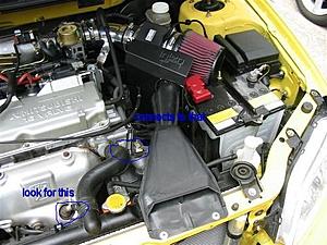

ok .. heres a picture of the thing that im looking for

jus get a 4-wire universal one. use your stock o2 sensor wires and cut and splice the universal ones in. A bosch universal before cat sensor is about $70.00. the OE plug ones are like 250.00

o .. thanks andy! .. i was thinking about that but then when i looked at the wires in the stock o2 sensor i saw 4 wires... 1 blue, 1 white, and 2 black but what does each black wire do? .. i dont wanna mix up the wire and F it up

before you go oue and spend a **** load of money on a new one do what i did and just use a locking wrench and put it on there really tight. I stripped the **** out of the one on my cat im talk totally round i couldnt even fit a open ended wrench on there anymore (the correct size that is) and i just put a locking wrench on there and pulled really hard and it came right off.

really? .. ok i'll try that.. i was gonna do that but i thought i was going to damage the sensor.. might as well give it a shot
