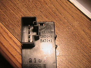

Hear you go... this is the back of your clock
ACC = ignition only
ILL = lighting only (turns on with running light, gauges, ex...)
GND = chassis ground
BAT = constant 12V
easy way to wire.......
on when ignition is on.
light_____ ( + ) _______________________________________ACC
|______ ( - )________ground (almost ALL metal surfaces)
on when guages are on.
light_____ ( + ) _______________________________________ILL
|____________ ( - )______ground
on depending on swich.
light __________( + )__________<switch*>________________BAT
|_______( - )_____ground
most swiches have 2 or 3 prongs (3 if it lights up). the packs usually lable the prongs, but when wired like this, treat ACC, ILL, or BAT as 12V source.
...and of course this works for anything that can run on 12V including radar detectors (that wire hanging from top to bottom is just not sensible... run it to ACC!)
HAPPY WIRING
