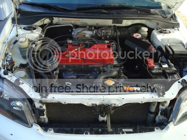

I used the autozone intake , and just cut the adapter a little shorter so it could look cleaner , and made a custom bracket so it wouldnt move around
Then i bought a injen heatsheild from ebay
Dont have a more recent pic with the header
