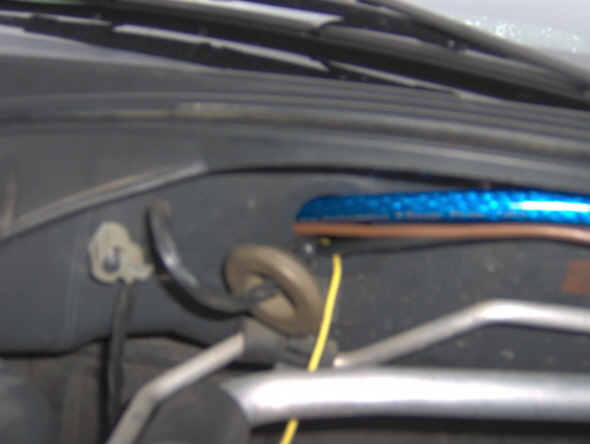

anyone with subs can help me out here, where is there a hole in the firewall where i can run my amp hookup wire, and the wire for my neons?, i currently have it going through the door jam and it looks like ****e, if someone could show me a pic of theyres i would be mega thankful... or you can describe it that would be ok too, thanks!

Isn't there a hole near the pedals and a hole near the glove box? Look around for a rubber plug...

the best one is on the passenger side behind the glove box. just stick your head down there and you should be able to see it.

thats from the engine bay
and thats where they come out behind the glove box
Hope that helps...

hey thanks alot everyone, especially thunderoz with the pics, im going out to my garage to rerun it now, but i think i might need some more wire and some couplers, oh yea i have an auto if that matters

the hole that i previously used for my amp wiring and am currently using for my wideband is right behind the clutch pedal. you can't really see it from the engine bay, but it is underneath and slightly to the right of the master cylinder.
