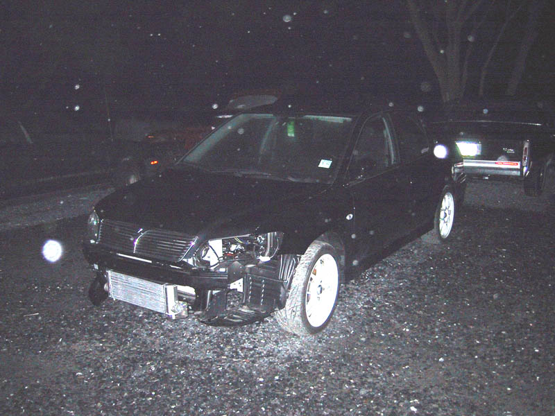

Now for some of the pics from a month ago...no intake piping on at this point, but it gives you the gist of what it looks like.

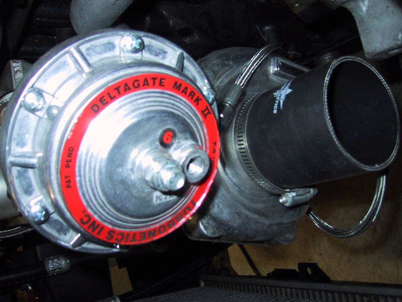

1.

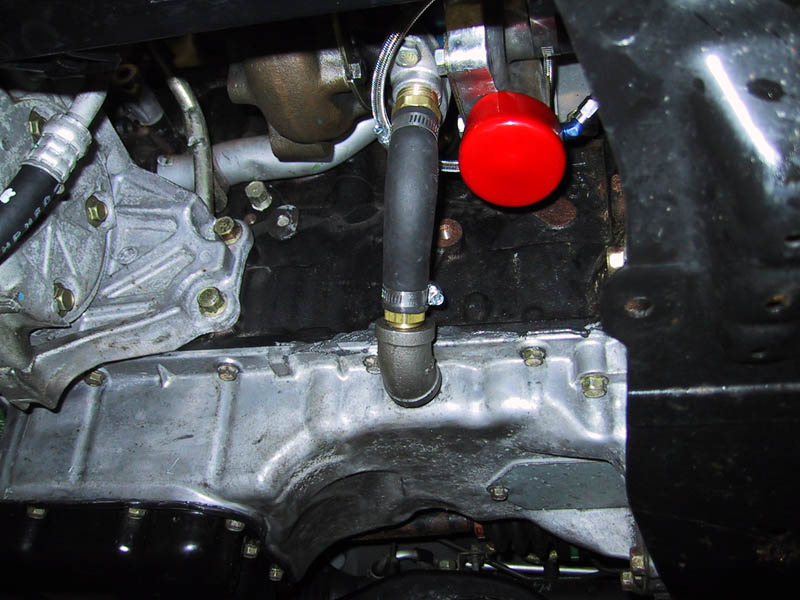

2. (For those of you who were wondering what my avatar was)

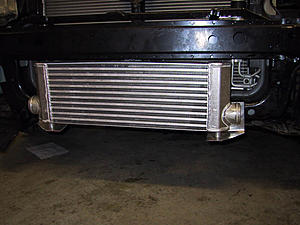

3.

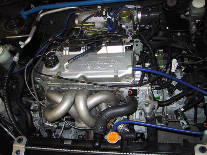

5. (the final pic from this batch...and not a very good one.)
