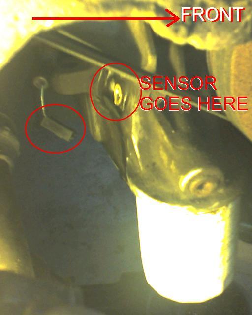

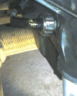

i changed it this morning.... problem fixex.... took pictures, will upload later
a tip, jack up the right front side of the car, turn the wheels a bit to the left
pull the plastic cover that's right (towards the front) of the suspension and wedge it on your brake rotor, this gives you full access to the sensor
pull the cable off of it, unscrew it (might need a wrench)
DON'T forget to put something underneath to gather up whatever oil will spill (not much but some will spill)
put some teflon on the new sensor (as little as possible, otherwise you'll have a hard time screwing it back in
screw the new sensor in, but only halfway (look at the thread of the old one to get an idea how far)
replug the cable, put your tire back on, lower down the car and voilà!
i also picked up a new horn and replaced my old rusted one.... MUAHAHAHAHA
it's a Hella...got it for 9$....i might get a second one to replace the other horn which is almost falling apart..
too bad they're hidden behind the bumper because they look nice

Here are the pics, they were taken from above the right front brake rotor
you can see the alternator strap running diagonally across the top and the oil filter at the bottom right for the pictures

^ Thanks for posting pics Rancid, they helped a lot. Installed it today and problem is solved!!!
