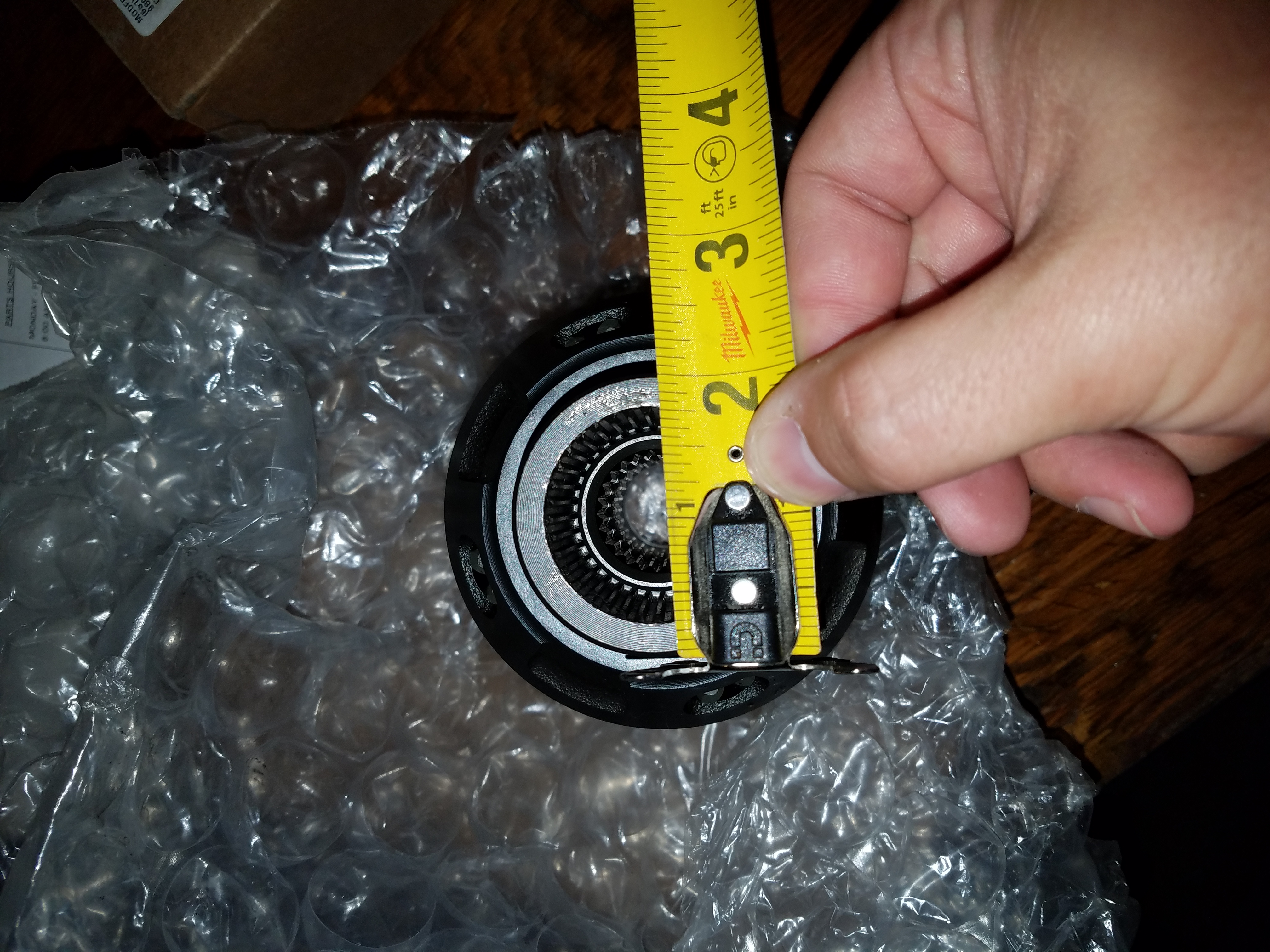

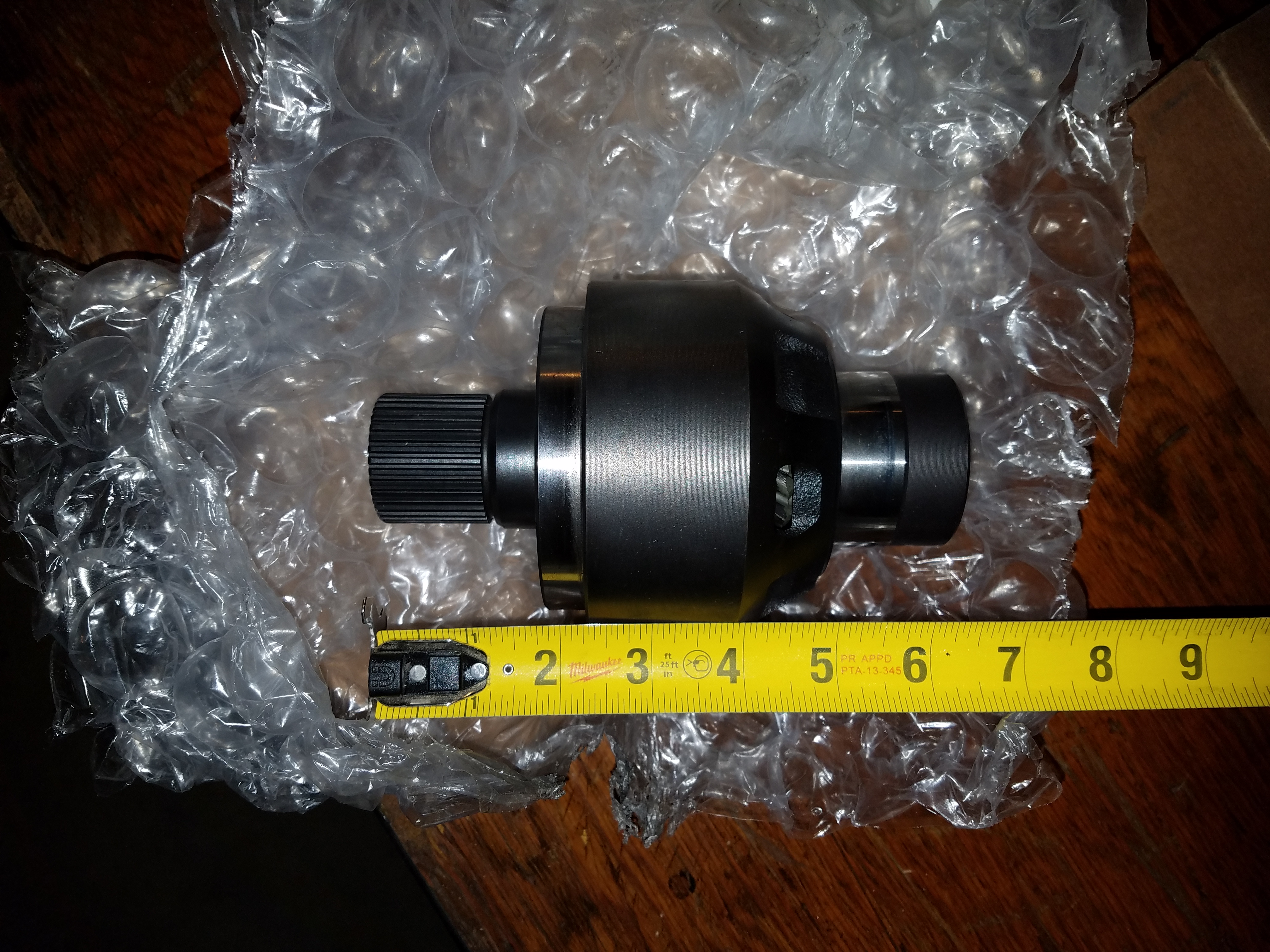

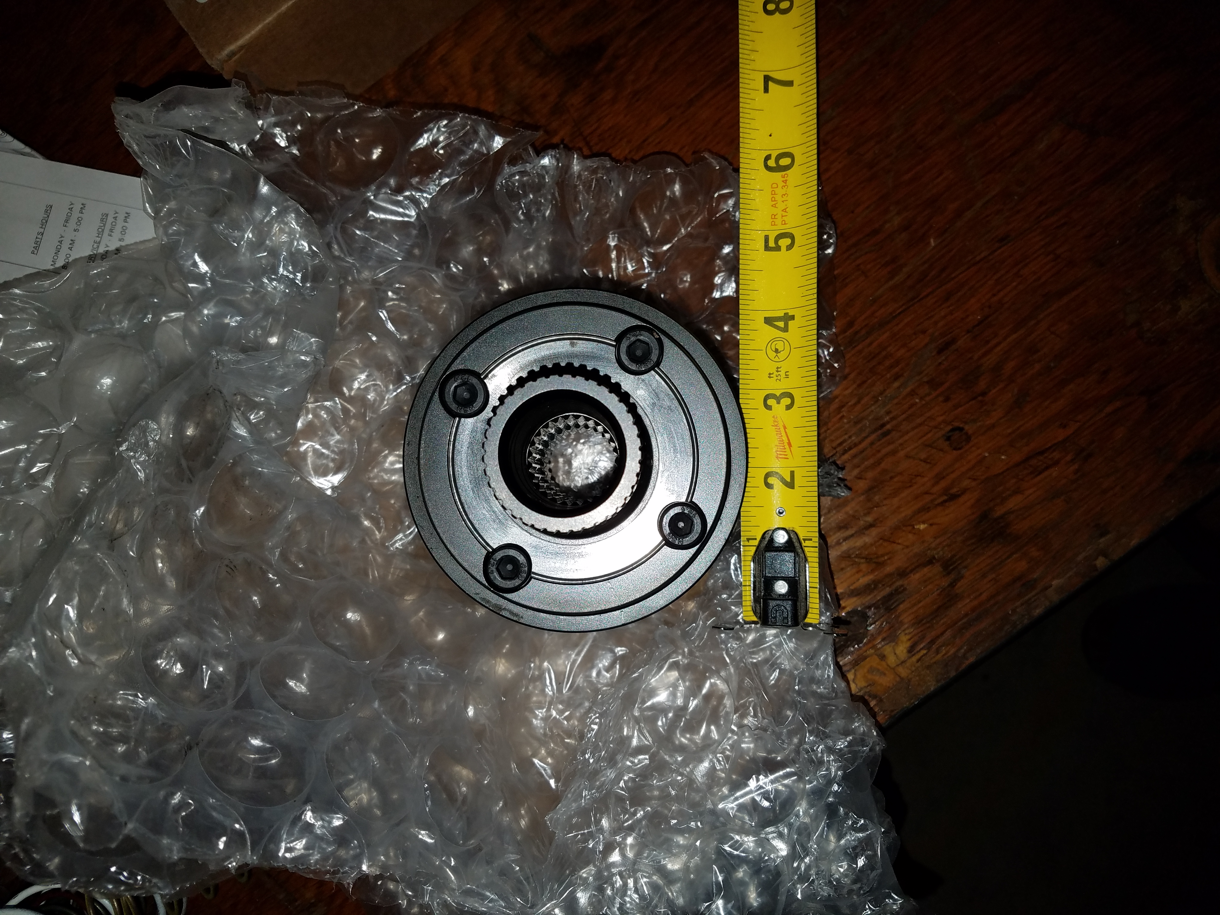

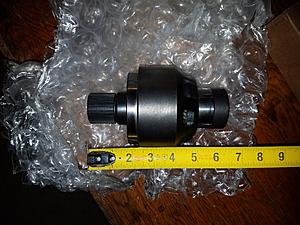

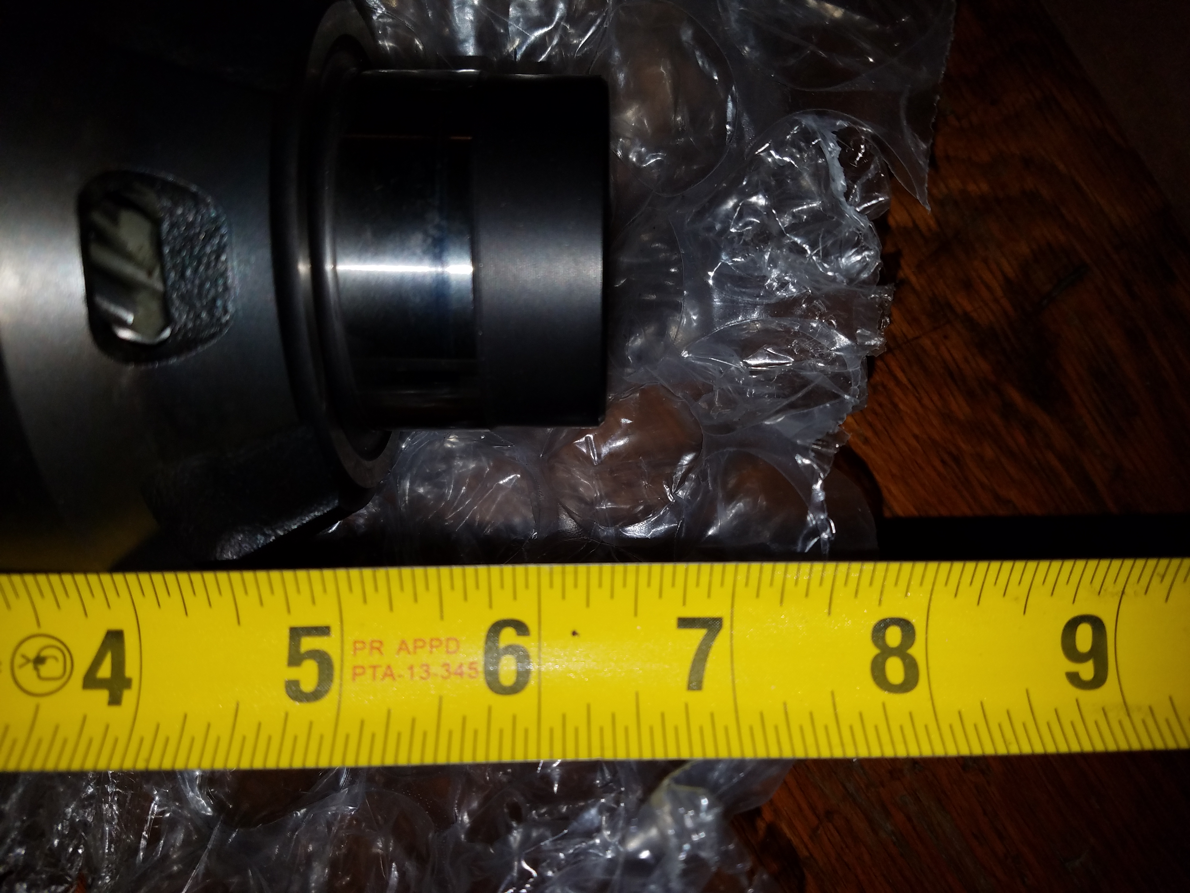

From: Maine
Sorry if it was mentioned already, I looked and didn't find or see it, but does anyone know if an evo 9 front lsd fits in an 02-06 lancer ls/es base model? I have an evo with a built trans and tcase from Jack's transmissions so I have a spare stock lsd that a buddy of mine is seeing if it works in his 02 lancer Oz rally. (Not the 2.4L ralliart) thanks!
Old Aug 5, 2016 | 10:36 PM
  #237
CrAnSwIcK's Avatar
Joined: Sep 2010
Posts: 7,472
Likes: 89
From: Ontario, Canada
I doubt it, but you never know...can you take pics and measurements of it?

Sorry if they don't come out to good quality...but here are a few pics of my evo 9 front lsd.
where's the final drive gear? That definitely won't work...does that piece come out of the tranny, or the transfer case? sorry not familiar with AWD transmissions.
Old Aug 9, 2016 | 02:51 PM
  #240
LetsGetThisDone's Avatar
Joined: Oct 2013
Posts: 15,973
Likes: 1,629
The evo front diff is inside the tcase and will not work in a lancer fwd trans.
