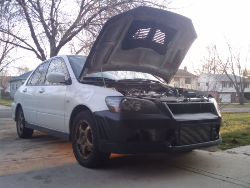

I don't think the strut bar will fit since our intake manifold sits a lot higher so there might be clearance issues.
The Evo hood rain guard does fit if you have any aftermarket Evo hood.

johnny-
whats the manufacturer of theat hood and bumper?
Old Nov 11, 2009 | 03:23 PM
  #51
OZ Rally's Avatar
Joined: Jul 2008
Posts: 1,438
From: Illinois
Hood is Accolade (Don't recommend because it weighs a ton and doesn't fit the bumper correctly)
Bumper is from Extreme Dimensions or something like that.
Hood rain guard will fit any aftermarket Evo hood.
Are you sure thats our hood? It doesnt look like it but its hard to tell, If you try to use our Evo VII hood it wont work with an Extreme Dimensions bumper.. The Accolade Hood must go with the Accolade Evo VII front bumper.
Yes it is your hood with the Extreme Dimensions bumper. Looks like I need to buy another hood.
