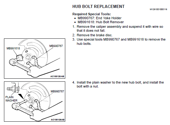

You don't need to remove the hub from the spindle to replace the wheel stud. Remove your wheel, remove your caliper and then press it out. Below are the instructions from the FSM.

Yeah i didn`t know if there was a cut of to take the lug stud out but there was, it was fairely easy to do except pull the studs in so they arent loose, i had to use washers and one of the wrenches and an extra lug and tighten all the way down so they pulled back in and locked into place.
THank you guys for helping me.
