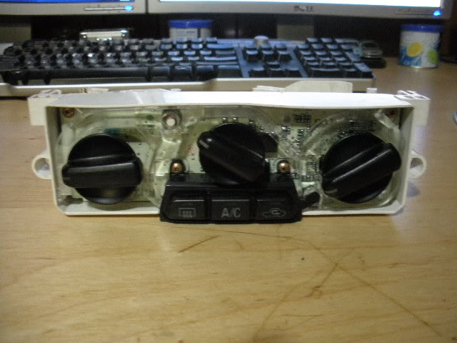

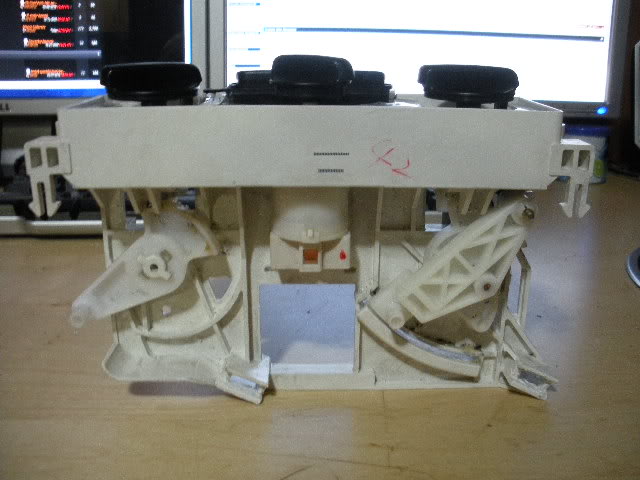

Anyone ever break one of these knobs? I know it's usually because of the cables. It happened to me. It sucks. Pretty expensive from the dealership. Anyway, I have two control units available I originally bought used for my 2003 Lancer. Will ship for cheap. PM me if you need one.

Not a recall but a TSB.
2003 Mitsubishi LANCER EVOLUTION 03 - Windshield Defroster Defogger > VISIBILITY : DEFROSTER/DEFOGGER SYSTEM : WINDSHIELD : CONTROLS/WIRING [Part 138130 ]
TSB No: 0455003 NHTSA ID: , March 01, 2004 : Replacement:
Summary: heater temperature dial hard to turn. *tt

i know this isnt very helpful since i dont have a link or part numbers or anything, but i think makes gears to replace the hard-to-turn components of the temp selector knob.

the only tsb related to the hard to turn issue is one mentioned above
the tsb is uploaded to the link below
--> http://www.megaupload.com/?d=T48GJFK2
parts only cost me $25 from the dealler to fix the hard to turn issue
i dont know what the part number is for the knob itself, that i has to look up

and i just wanna kill the ****** that thought it would be a good idea to put those two sliding pieces instead of gears. really dude, wouldnt gears have required less engineering and manufacturing cost?

So its not just me, When I turn the temp selector I feel like I have to put alot of pressure on the knob and then it finally turns over.

Yes, your problem is directly related to the cables that connect to the control unit. I highly suggest you stop turning the dial, and replace the cable connected to your temp dial. Otherwise the thing will eventually break off. Best of luck!

its act 2 new gears that get replaced not the cable relating the hard to turn issue.. thats all i needed to fix my car
tsb ---> http://www.megaupload.com/?d=T48GJFK2
