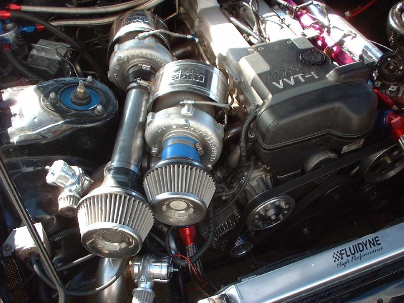

Not really. Most full turbo kits, like the one from RRM, use custom made piping that brings the intake tubing next to the exhaust (turbo) manifold to connect to the turbo. (Hence how a turbocharger works).
Most of the time the filter for the intake side of the turbo is right off of the turbo like the picture below. This is because theres usually no extra room for more piping. Most people just use an Intercooler to cool incoming air.
