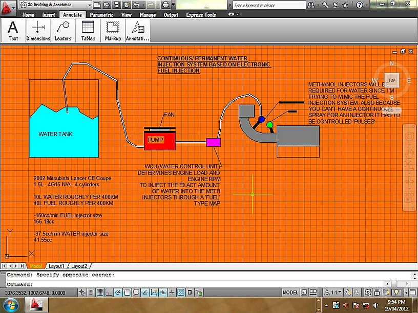

I am thinking of putting a water injection system on my 4g15 N/A to show that I can get the same performance out of the engine but with reduced fuel consumption. There is a pic of my setup so far and you are free to pick at it since it will only improve through your feedback! Cheers
