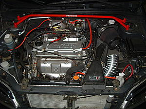

It won't matter much if it's behind the battery a little. I guess you could say it's further from the hot engine that way. And you could always route colder air in like engineerboy said. Here's a pic of one of my former setups. It went from the bottom left side grill up to the filter. I just happened to use the hole from the stock plastic scoop, but as long as you zip tie/wire/bolt it so that it faces the filter, you will get plenty of fresh air for it to breathe.

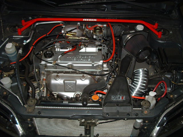

Here's a pic of my new setup, it's just zip tied in place (and works alongside the stock scoop). For reference, the previous picture was just 3" dryer ducting with a coupler cut into 4 slices to fit into the hole and a 3x9 funnel. This pic is 4" ducting with a similar funnel mounted underneath the car. I know these help because the filter got dirty quicker where the ducting pointed at it.

Edit: Urban..u can see the dirt on the filter

Yeah, actually it's oil from after I cleaned and oiled the filter. The dirty park stays darker, and the whole filter got a deeper red, so I guess not all the dirt goes away?
