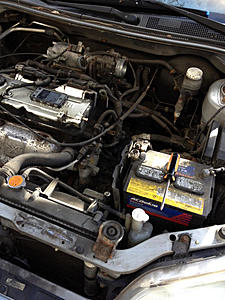

Thanks . I'm positive it's the battery my headlights won't turn on or there like really really dim and you can't tell. But when I jump it then the lights work. And yes my battery has a lot of corrosion I'll take a pic for ya . But I tried to remove my battery but the ground cable(the black one) won't come loose only my red on does (positive cable)

You can see in this picture I took a whole ago that it is pretty corroded
