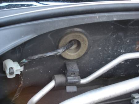

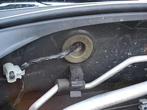

What should have been a thirty minute to an hour install too myself and N1te much longer because the two of us didn't know what the hell we were doing. Here are a few pics for reference. I'll post up a few pics that might also help with the install as well later.
Not the rubber grommet:
The actual rubber grommet is located directly behind the passenger front strut and has to be pulled out.
Gabe at RRM sent us this pic... this is the hose you need to pull.
Fox
PS- Gabe at RRM is my hero. If I were a chick I'd be all like, "can I have your baby..." But I'm not. But he is still cool.

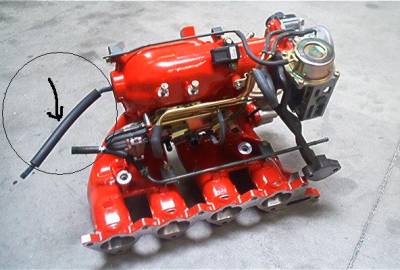

13) Connect the Piggy Back’s vacuum line to the line provided and route it to the intake manifold. Use the Tee provided to connect it to the same line used for the stock fuel regulator then cut off a piece of the supplied line to connect to the manifold where the stock regulator was connected.. There is a rubber grommet sealing a hole just behind the passenger side strut. Remove that to route vacuum line from inside the car to manifold.[/B]
can someone post a pic of what that looks like, i think thats where ill have the most difficulty, it isnt too clear cut to me, i need pics... thanks ALOT

Of what? The grommet to remove behind the strut tower or the vacuum line from the intake manifold?

the vacc line, im me on AOL or AIM, MitsuLancerRacer

is this how the vacc line hooks up?
i did that real fast in paint shop.

Ya, that's how I did it.

Yup!
