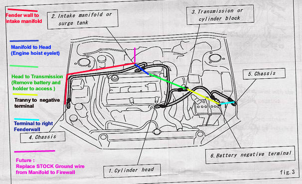

jtc - while the help is appreciated, that is a manual for Evos.
I think I have a pic that someone suggested to me for Lancers...
