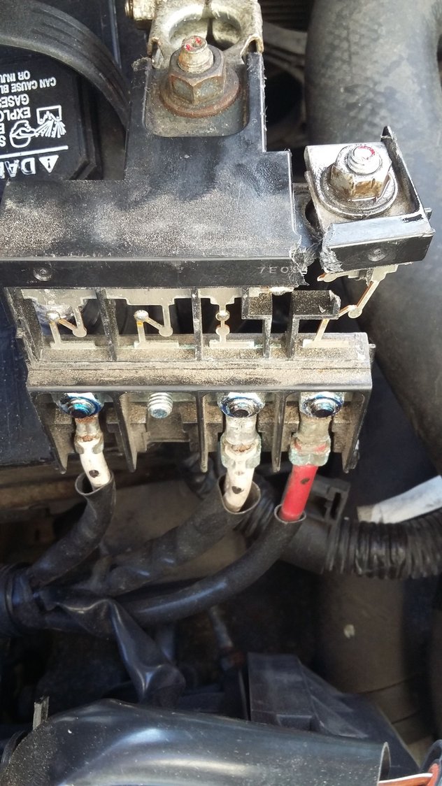

I have a 2008 Mitsubishi Lancer that had a aftermarket remote starter installed way before I had gotten the car. It had been draining my battery for some time now and I want to disable it. I seen the extra cable coming to the top of the terminal box. Went to remove it and ended up breaking this.

That sucks man. Sorry to hear that. Do you know what brand it is?

Prestige platinum by audiovox
I got it running again but yet to fix the draining of battery after 5-6 hours of inactivity.
