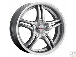

I just got new rims for my car and they have a center cap. I needed new lug nuts because the stock ones with the cap was too big(acorn shape). So i needed lugs where the bolt went all the way through. I went down to checker and found the right size and got all set up. About a week later (today) my wheel start knockin like a mother and shaking and ****. I was crusing around 30 and i was like damn that cant be right. So i get out of my car pull off the center caps and find that all four lugs on my from right wheel are about to fall off. And the car was like this | and the wheel /. I called my mom up and she came over brought the good jack and i took the lugs off and the threading on 3 of the 4 lugs was just ripped up and didnt look uniform at all. They were so bad that i could just push them on the bolt without turning. Thank god it was the lugs because the stock ones went on there with no problems. Anyone elsy have that problem??? I put them on there(the new ones that got all f up) real damn tight i had the big *** breaker bar and everything.
Just wondering does anyone else have any idea where i can get some good lugs that wont stripp or did i completely f' up the install.
thanks peace
Just to let you know what the rims look like and what im talking about with the center caps. \/
