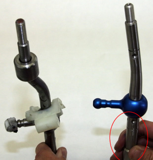

You're forgetting about the mechanical advantage that the longer shifter affords the stumpy bottom piece. The aftermarket shifters have longer ends below the ball and that's what really gives you the shorter throws... think of it as the lower end "stretches out" the shift linkage. So what happens is the top part can then be shorter.
Look at the pics of OEM and aftermarket in the install tutorials and you'll see the difference in length between the stock and aftermarket above and below the fulcrum (ball).

So... the part circled in red has to be longer in order to give a shorter throw? Sounds like the opposite, but it makes "mechanical sens"

Yes. Hold a pen, pencil, stick or whatever in its middle, straight up and down, between your index and forefinger.
With your other hand, gently push the top and look how far the bottom moves in response. Now shift it so you're holding onto the pen at a lower point and repeat. You have to move the top much more to move the bottom the same amount. Finally hold it closer to the top and look how short a distance the top travels to make the bottom move the same distance. Viola.

I thought about shortening my stock stick, but it has a bend in it. So you'd only be able to knock an inch off at most. I never paid much attention to the bottom length of the B&M shifter, but how does it still fit between the socket and the bottom cup if it's longer down there? Just curious.

I believe it's only slightly longer. Since it's pulling a wire it can't go too low anyway or it might cause problems. All I know is mine is a signficantly shorter throw than stock. The difference is like night and day. I think there's a total of 2-3" of travel between gears in my shifter. It takes some getting used to at first or if you've been driving a manual transmission with a regular shifter, but the difference is certainly noticable.
