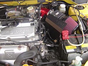

the air box is the big plastic square thing in the right side of the for engine bay.. its also connected to the funnel.. u have to remove all of that.. i cant really explain the whole install right now. install is pretty easy. just remember to disconnect the batt. and once u finish have it idle so that ur car will adjust to it
should look like this...
