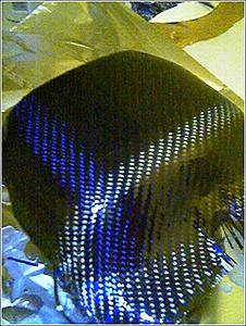

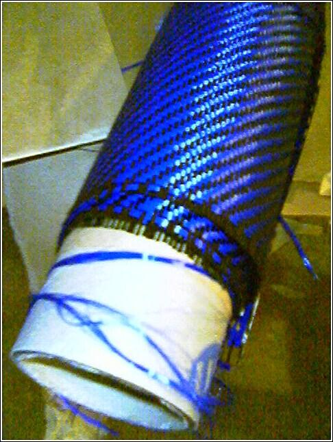

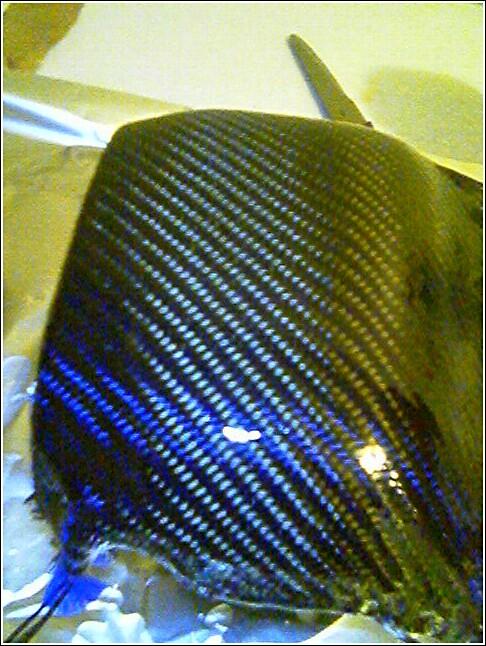

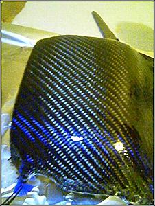

Well, after I've seen many people getting CF interior pieces, i decided to do my own overlay's. I've always wanted to do this ever since Kontradictions made his pieces on his own. And other members (Sirlancelot wink wink) do these overlays and don't show their family how to do it, even if it is as simple as spray glue and CF tweed, but I will. I mean how hard is it to share DIY's with your fellow members???

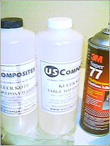

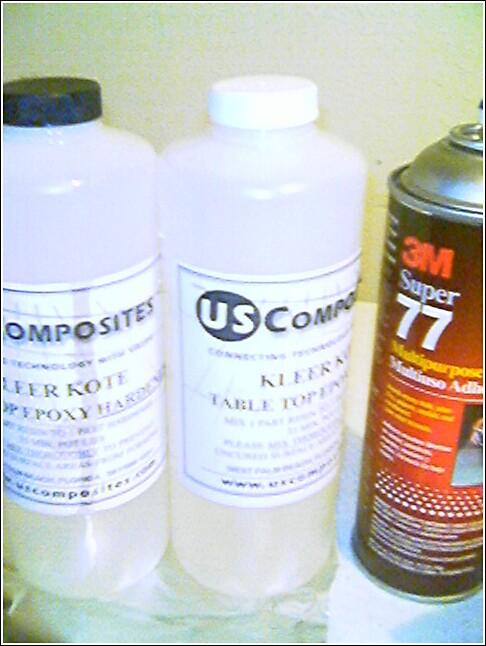

Well here I am going to list all the things I used. I also bought the CF fabric and Klear Koat epoxy from www.uscomposites.com (which got it to me in 4 days after I ordered it) but feel free to use whoever you want.
Items used:
- Blue/Black CF fabric
- Kleer Koat Epoxy (basically its a clear coat found on bar tops which give the 'wet' look)
- 3M Spray adhesive super strength
- Mixing Containers (bought a crap load from home depot)
- A measuring cup or glass (Be prepared to toss away afterwards)
- Mixing sticks (I used chinese sticks that I got from an oriental store real cheap)
- Very sharp scissors (I got heavy duty scissors from fabrics in walmart)
- Foil
- Whatever piece you decide to CF up
Basically all you have to do is cut the CF fabric big enough to cover the piece chosen. Spray the adhesive all over the piece, then apply the fabric very carefully, its fragile.
When that all done, let it dry for 20- whatever minutes you want.
Then the tricky stuff starts up. The kleer Koat consists of 2 bottles, one is hardener and one is the epoxy. the directions come with the bottles and are very detailed on what to do and what not to do. it is a 1:1 ratio. so you have to be real precise. after that, mix up the two chemicals in the mixing container until you feel is good enough. be careful though, it is supposed to be transparent when you pour it, if its still hazy or white keep stirring.
Pour the resin slowly, it spreads out pretty evenly as long as you go slow.
After all that is done, follow the instructions for the second pouring if you are not satisfied. If you are, then your done, wait two days for FULL CURE.
Here are some pics, I don't like to tease members.
Attached Thumbnails CF Projects: this can be you-chems.jpg   CF Projects: this can be you-cf3.jpg   CF Projects: this can be you-cf1.jpg   CF Projects: this can be you-cf2.jpg

the pic looks alittle distorted but is that you center armrest?
Old Mar 2, 2005 | 07:23 PM
Archangelite's Avatar
iTrader: (32)
Joined: Dec 2002
Posts: 1,035
From: Austin, tx
no, sorry about the pics, its the piece thats over the steering wheel.
Old Mar 2, 2005 | 07:24 PM
SIMSSEGA's Avatar
Posts: 686
nvm then the pics arent distorted then
i would never think od doing that peiece good call.
