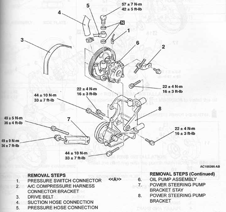

Has anyone drained and refilled their power steering? If so, do you have pictures of how you drained it (vaccuum, syphon, drain plug, etc.)? I plan to exchange my fluid with new stuff, but I am looking to use a method proven to work.

Could someone please post a pic from the tech manual of the Power Steering Pump, with it's related hardware? I would really appreciate it.

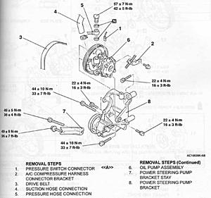

Old Jun 25, 2005 | 06:32 PM
comatose721's Avatar
iTrader: (16)
Posts: 1,425
From: Toms River, NJ
here are the shop pics...i hope this helps.
