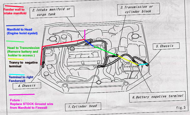

I found these on this site a while back...
Attached Thumbnails Ebay Ground Wire Kit-ground-wire-instruction.jpg   Ebay Ground Wire Kit-groundkit-setup.jpg

wow thanks b-sr this is a great start.
