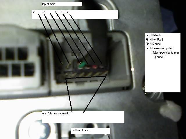

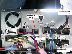

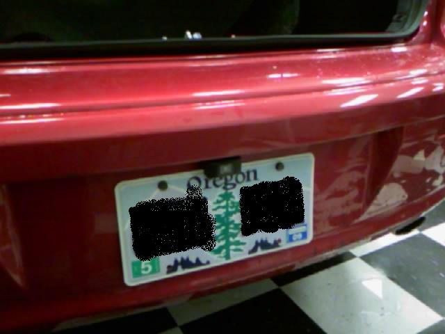

No actually on the Lancer, atleast the US version, it doesn't have the harness at all, nothing is pulgged in. Here are some pictures of the plug layout also where you can get accessory power for the camera, and where I mounted mine. The View works very well there.

Here are some more pictures to help a little. looks like the picture quality is getting cut down pretty bad but you can get the idea. just remember all of the pictures were taken as if the radio was in the dash and you were looking at the back of it, Not what you would see if you pulled it out and let it hang looking at it that way, I labeled the antenna ports so you get prospective.
As far as most of the wire run goes that is pretty straight forward. You need to pull the still pannels to hide the wires/rca.
The acc. wire is labeled, but you should use a meter to be sure. I used a bolt on the side of the radio for a ground, and used a DEI Antenna harness for my cam harness.
