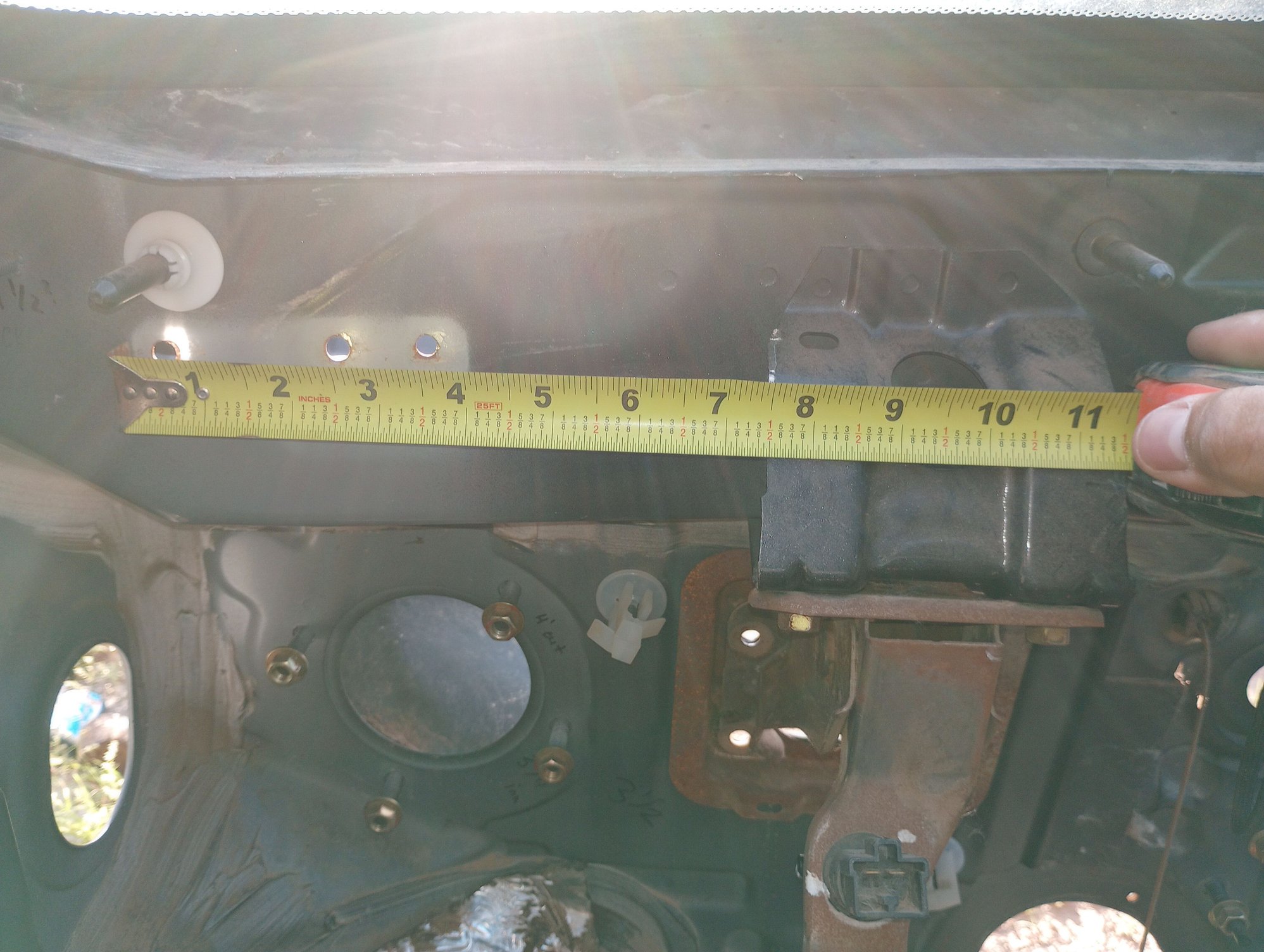

1 measure the parts car Clutch MC mount plate and hole size and the Clutch Pedal Mount bracket
2 copy over measurements to car being used and take the clutch MC mount plate
3 back at parts car drill the 6 welds that hold the clutch mount bracket to the firewall below the windshield and use a flat or pointed putty file idk what it's called but it's thin and use a rubber mallet to hit the handle and pop off the mount go easy on it cause I bent the mount a bit but it bent back
4 mark up and measure the placement of CPM bracket and CMC mount plate
5 double check measurements and placement

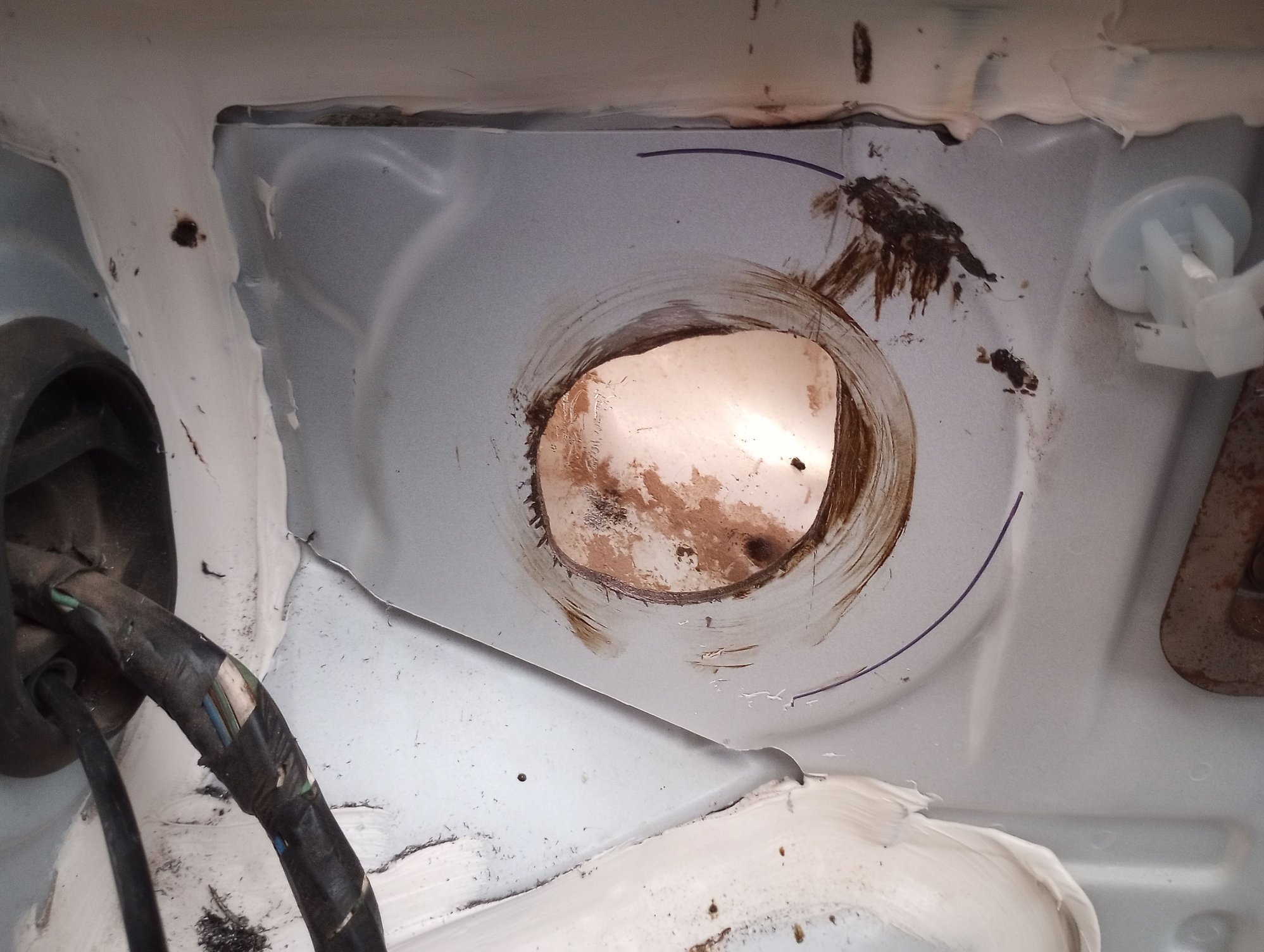

6 start drilling the hole and bolt holes for CMC mount plate, make sure the little arrow is facing the brake pedal assembly
7 attach Clutch Master Cylinder and mount plate and bolt it down to firewall and attach Clutch Pedal assembly
8 attach CPM bracket to pedal assembly and get it close to your measurements and start drilling six holes to mount the bracket to the firewall, I drill one hole in the middle top first took everything off and finished like that depends on how big your drill is if you need space9 you should be done make sure everything else sits right and functions as it should

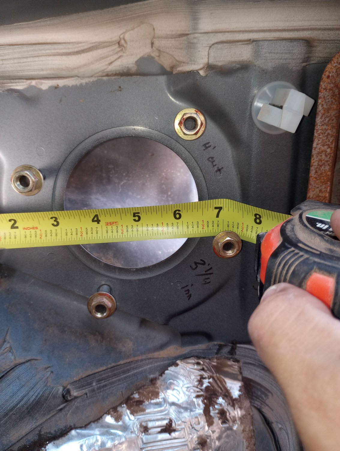

End of hole was about 6-3/4 in away from firewall, hole diameter was about 3-1/2 in shy about 1 or 2 cm so I decided to go with a 2-1/2 in holesaw and work my way out from there with wd-40 and a rounded file.
I measured from clutch to brake pedal mount was about 11 in, also the the three holes I drilled on top near 1-3-4 there's three more on the bottom, I just took the mount and marked holes and kept measurements in place on automatic car
Everything all said an done it ended up at 11-1/2 inch's but looks good almost like stock

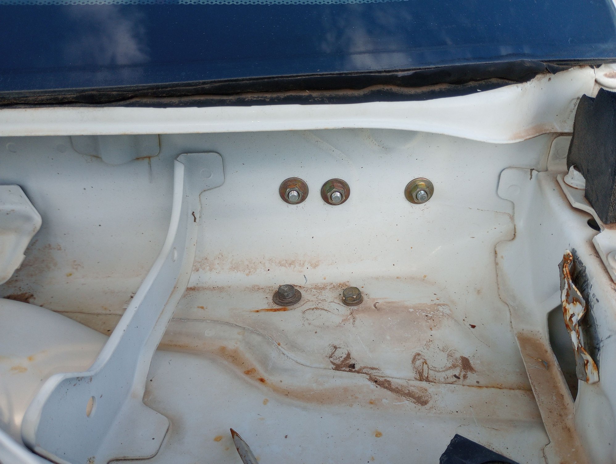

Had the window wipers removed, so I put Five 10mm bolts to hold the clutch mount could not get last one drill was to big but it's nice and secure with five going to put loctite or something on it for insurance
Hole drilled and you can tell how I used the file it was trial and error and after I felt it was good enough I got clutch MC plate drew a circle and bolt holes with arrow facing brake pedal so CMC doesn't sit upside down
That's how it sat completed I ended up using on 12mm nut and bolt and 3 10mm nut and bolts just cause I kept losing my 12's it's also secure, would caution to be careful not to drill into brake booster
