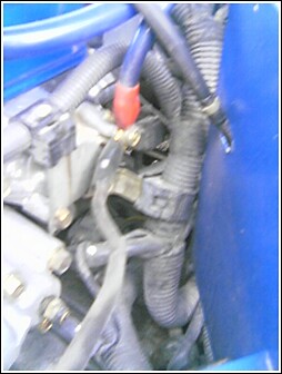

ok, heres a pic, sorry i made it myself in 2 mins, looks like ****. but the Basic idea is there. credit to redbeard for using his pic off his profile.
points:
1. the wall of the engine bay right next to the battery is a bolt with approx. 2 wires connected, just unbolt add your wire and rebolt, do not forget any of them!
2. from the wall you lead it to the negative battery poll. then lead a new wire to point 3
3. next the the valve cover there is a bolt here, unbolt , connect your wire from point #2 and connect a new wire to lead off of this point. rebolt.
4. point four is next to the throttle body, on top of the intake manifold. unbolt, connect wire from point 3 and connect a new wire to lead off of this point. rebolt.
5. this point is kind of hard to see. it is towards the bottom of the engine bay located on the wall. better explained, its next to the passenger wheel well. unbolt, connect the wire from point 4 and connect a new wire to lead off. rebolt.
6. this bolt is next to the valve cover on the otherside. it next to the engine hanger(the 'hook' that the engine is pulled out of the car with) unbolt, connect wire from point 5 and conect a new wire. rebolt.
7. the last one, is like a mirror image of point #1. on the otherside. cant be hard. you know what to do.

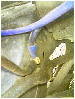

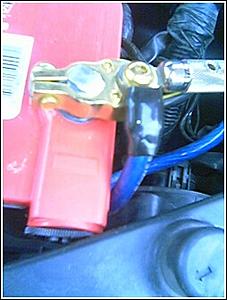

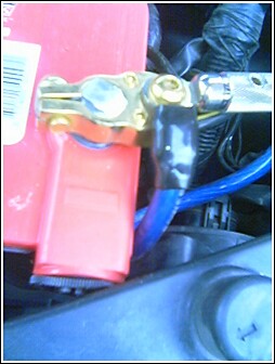

here are some pics i took right now.
point 1,2,3,4 in order
Attached Thumbnails cool ebay product-point1.jpg   cool ebay product-point2.jpg   cool ebay product-point3.jpg   cool ebay product-point4.jpg

is that for the circle one too... what should i do with the battery connecter and the brass plate.
Old Oct 4, 2004 | 04:45 PM
Archangelite's Avatar
iTrader: (32)
Joined: Dec 2002
Posts: 1,035
From: Austin, tx
i have no clue about that. but i would generally think that the plate goes on the battery connector and then you dispurse all the wires to all the points.
