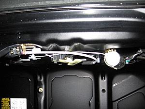

Originally Posted by drucea
ok the 03 wing is really different. you got that center post. and on mine, that hexagonal shped thing is just a stopper that can be raised or lowered. hey whats that greenish wire coming out with the other wires?
That is the wiring to my automatic trunk popper I installed
Attached Thumbnails OEM Spoiler Question-trunk-012.jpg   OEM Spoiler Question-trunk-013.jpg

sweet i need to get one of those.
