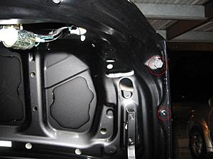

ok if the pic shows up ok, its the left side of the lid. The two highlighted circles farthest left are the two spoiler bolts covered by robber things. The long highlighted part (I believe the black one) is the brake light wire. look on the roof inside your trunk and see if there is a connector next to the light.

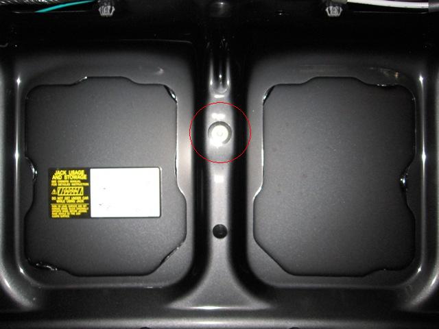

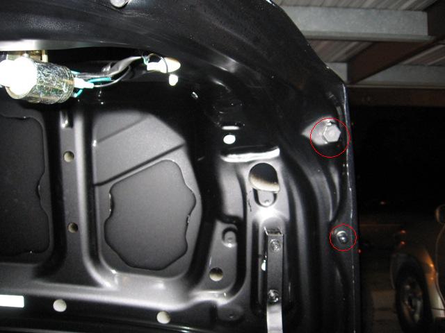

Here ya go. I just took these tonight. The red circles should answer all your questions. I circled where the bolts were that hold the spoiler as well as where the third brake light connection is under the rear deck by the dome light.

ok the 03 wing is really different. you got that center post. and on mine, that hexagonal shped thing is just a stopper that can be raised or lowered. hey whats that greenish wire coming out with the other wires?

Thanks so much!! You guys ROCK!! Mystery solved...the ES actually has pre-puched holes in the sheet metal right where your bolts are, which will make for an easy install! The wiring harness for the brake light is pre-installed in the trunk as well. As far as the OZ spoiler goes, though, my car is Rio Red (R20). I know someone who can get me a great deal on an OEM certified (aftermarket) spoiler that is pre-painted! All I need to do is make an order...THANX!
