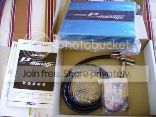

*edit* ordered the e-manage yesterday afternoon and received it this morning!*
just ordered greddy emanage and fuel pump! WOO WOO. talked to my tuner today, i wanted to save a little extra money so I asked him if I needed a wideband. he can accurately tune on his dyno because he has a wideband which is sweet. pics of parts coming in a couple days! anyone in vegas lancers/or evos ever get tuned by this guy? he's with silver state motorsports and tunes for the mitsu shop right next to him also. so far i've been getting great feedback from him and i'll let you guys know how great of a job he does. so you soon to be boosted vegas lancers have a tuner!

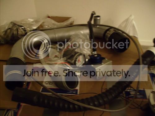

updates!! received a couple of parts today. the rest of it comes tomorrow in the morning so i'm going to get up bright and early to start on install. thanks alot to thereason.
evo 8 intercooler
tial bov
the rest of what came in the box. vortech fmu. autometer boost gauge. piping, bolts, washers and gaskets.

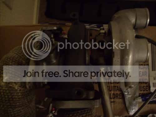

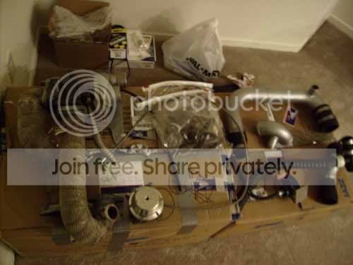

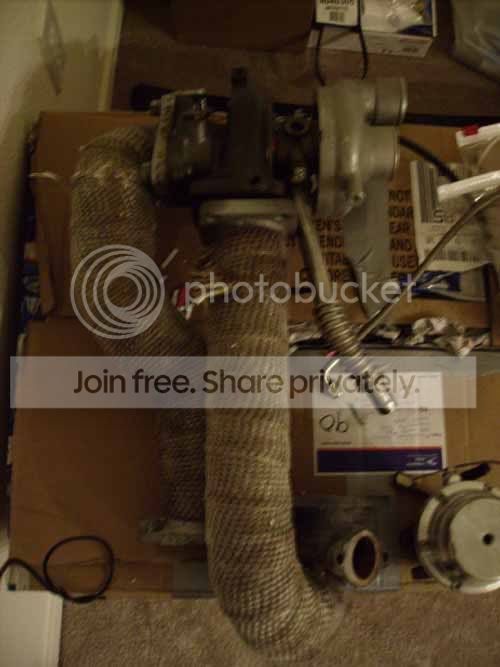

got almost everything that i wanted to do before the install. still waiting on gauges and cone. once I have everything i'm going to schedule a date to install. here are pics of what I have.
whole kit w/e-manage in the back.
turbo set-up
