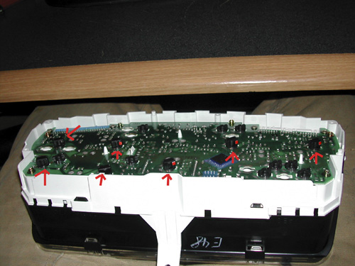

Now the bulbs. The t1.5 bulbs are a direct replacement for the ones in the stock gauge cluster. The only problem is polarity. LED's for behind the gauges and odometer go with the red sticker facing down. I think this is the anode, but haven't done any electronics stuff for a couple years and can't remeber to well. If you get the LEDs from superbrightleds.com the red sticker goes down for these. For other lights, fasten seat-belt, low gas, open door, etc... Have the red sticker facing up.
This pic shows which leds I replaced, looking up from bottom of cluster.

so are all the numbers and redline areas now blue? It's hard to tell in your pic. Got another? (trust- I know it's a PITA to take that pic. I've posted about a dozen)

Wasn't able to get a good clean pic yet, but the redline areas are still slightly orange, the plastic itself is colored in those areas.
