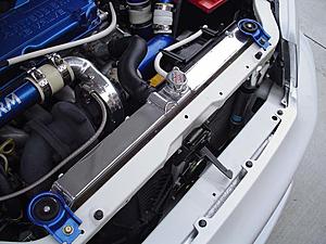

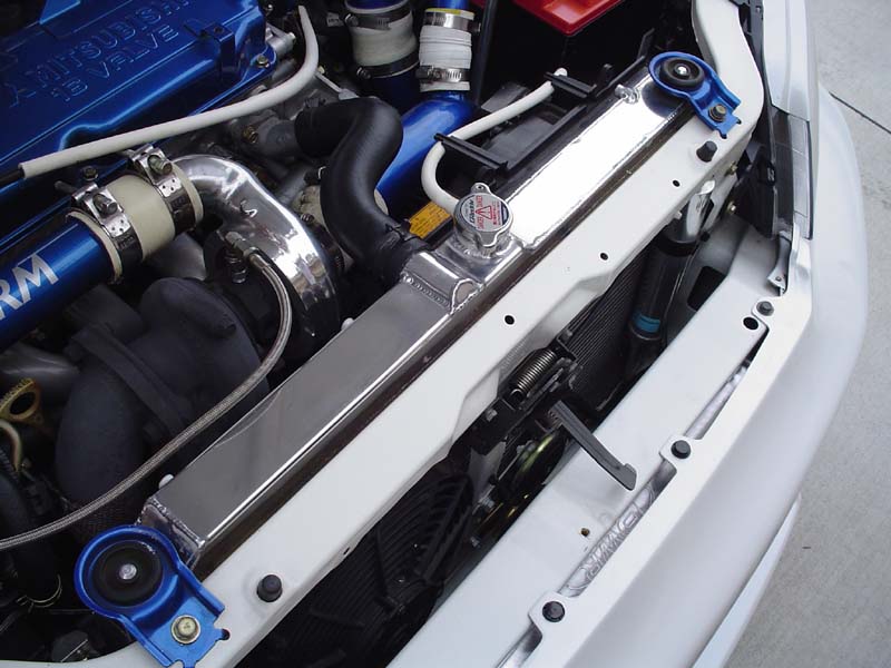

polishing the turbo housing is an option, like i did. I did the polishing myself and it was pretty straight forward, but it took some time. I spent about 4 hours polishing that piece alone. The piece is cast aluminum so it will polish up nicely if you choose to. Since it is cast aluminum there is a textured layer that needs to be sanded down hard, i used a dremel tool and a sanding bit, then after that i sat and wetsanded the entire piece moving from a low 400 grit all the way up to a 1500 grit for a fine finish. After that i used a polish wheel and compounds to give it that luster you wanna achieve. Looks good and here is a sample of the finished product....
