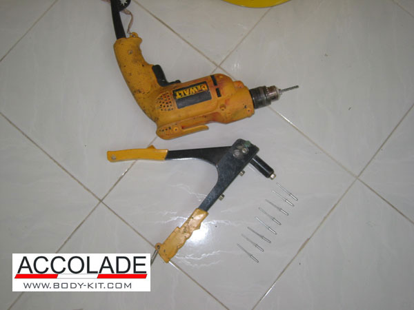

Originally the rear bumper is Attached to the Metal Piece with Rivets.
To remove them you have to drill the rivets.
these are the tools you need to remove and fix the rear bumper.
Drill machine, Pop Rivet Gun and Pop Rivets ( 1/2 inch)
1st remove the bumper and the drill off the orginal rivets.

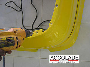

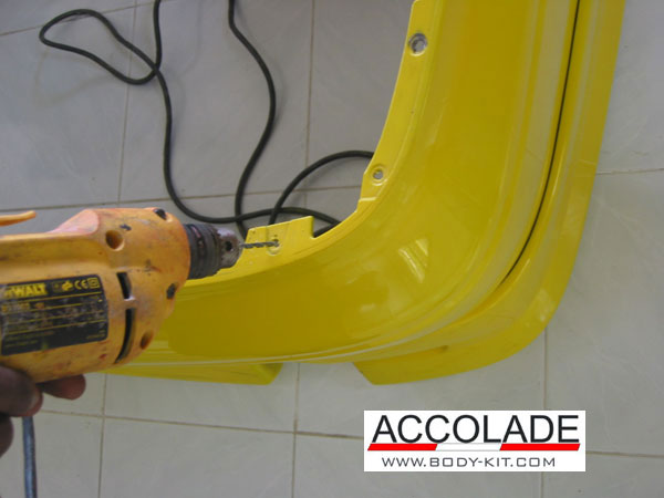

Once you drill the rivets, remove the metal piece. place it on the bumper you are planing to fix and from the under side you can mark it with a pen and drill it.
Remember even if not our bumper contains all orginal markings so you can easily mark it from the top.
First drill holes, now REMEBER NOT to use a drill bit which bigger than the pop rivet head, REMEMBER this always use a drill bit which is equal in size to the pop rivted shaft.
