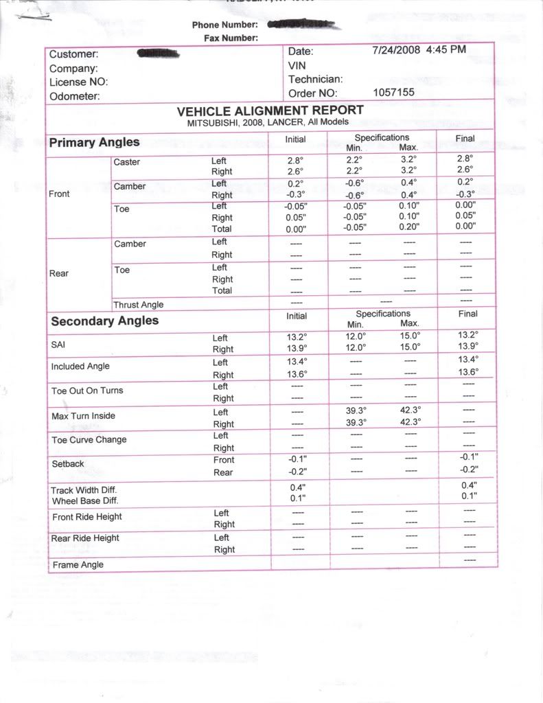

Are people still having this problem? I went in today to get my alignment done and talked with the service manager about the pulling to the left problem, (which he is aware of cause he's had to replace tires on a couple lancers already cause of it).
My alignment showed really close to center and didn't need to be adjusted, they did a rotate and balance also. I pull off the lot and its pulling harder to the left than it was before, drove right back and made him test drive it. So now I have to go back in tomorrow, so they can try to figure out the problem again. Maybe I should do like him and get them to pay for the aftermarket rims and camber bolts
Here is the print out of my alignment check they did today.
