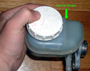

"filled to the brim" isn't necessarily good. overfilling the 'system' can cause premature failure of the slave cylinder.
what i forgot to mention is this-->the resevoir that houses the brake fluid is also responsible for housing the clutch fluid. they are one in the same. HOWEVER, there is a small divider in the resevoir to seperate the brake lines from the clutch line. a lot of times the resevoir appears full BUT it is not. shine a flashlight into the resevoir and check the level in the backside. i'll post a picture to clarify what i am talking about.
EDIT: here are the pic's to give you an idea of where you are looking.
mark
Attached Thumbnails Slave Cylinder Question-mc-001.jpg   Slave Cylinder Question-mc-002.jpg   Slave Cylinder Question-mc-003.jpg
