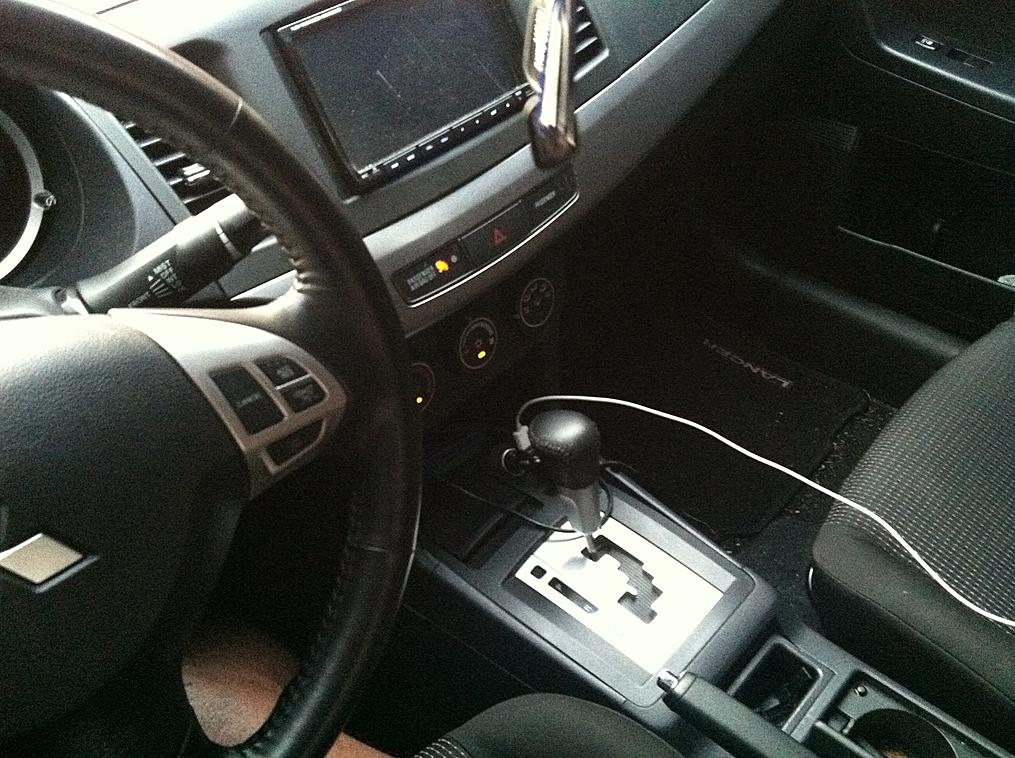

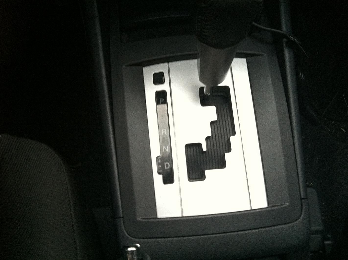

just swapped it out today been driving in sport mode all day it took about 45 minutes but only because it was 101 degrees here today i was dyinggggg
