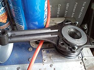

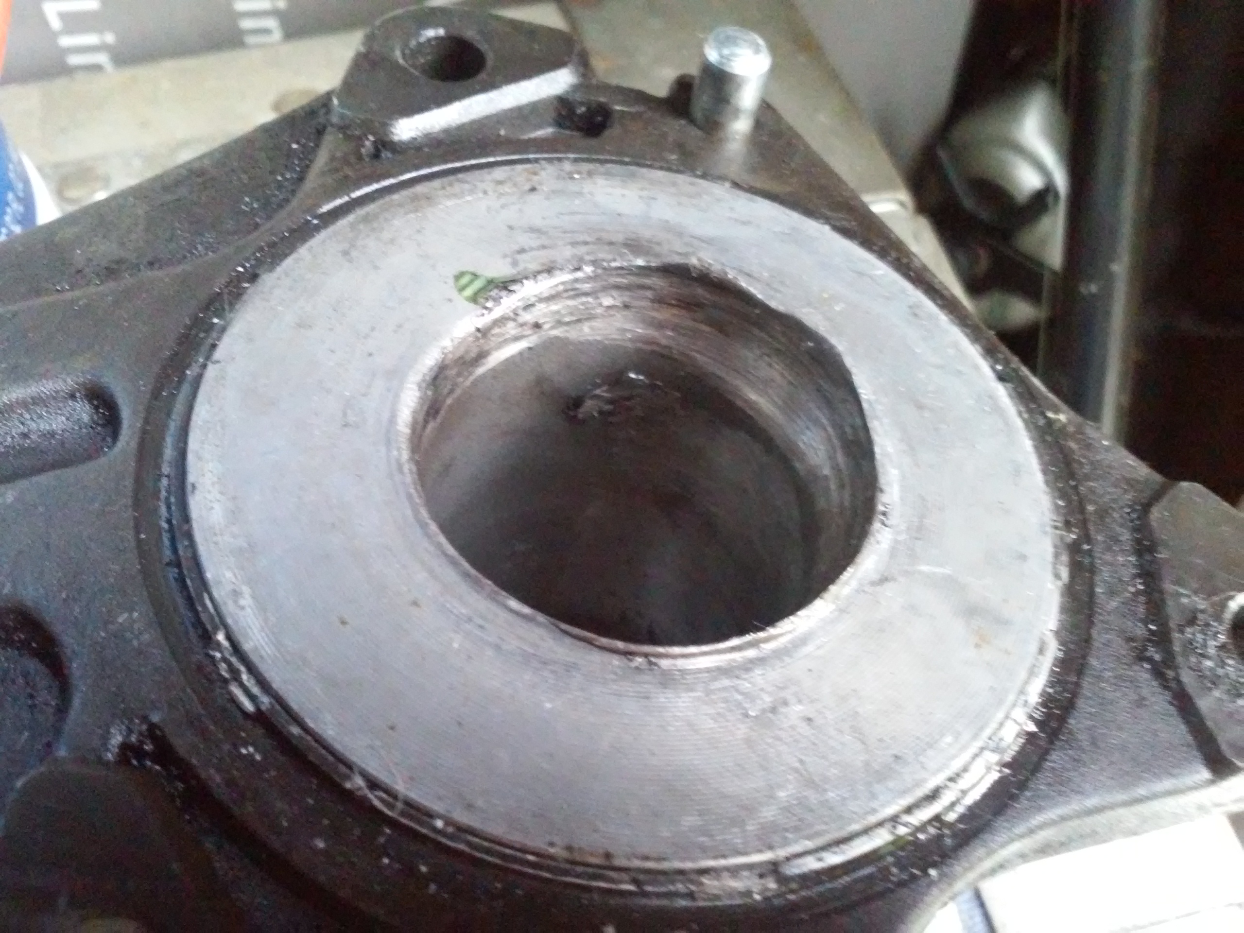

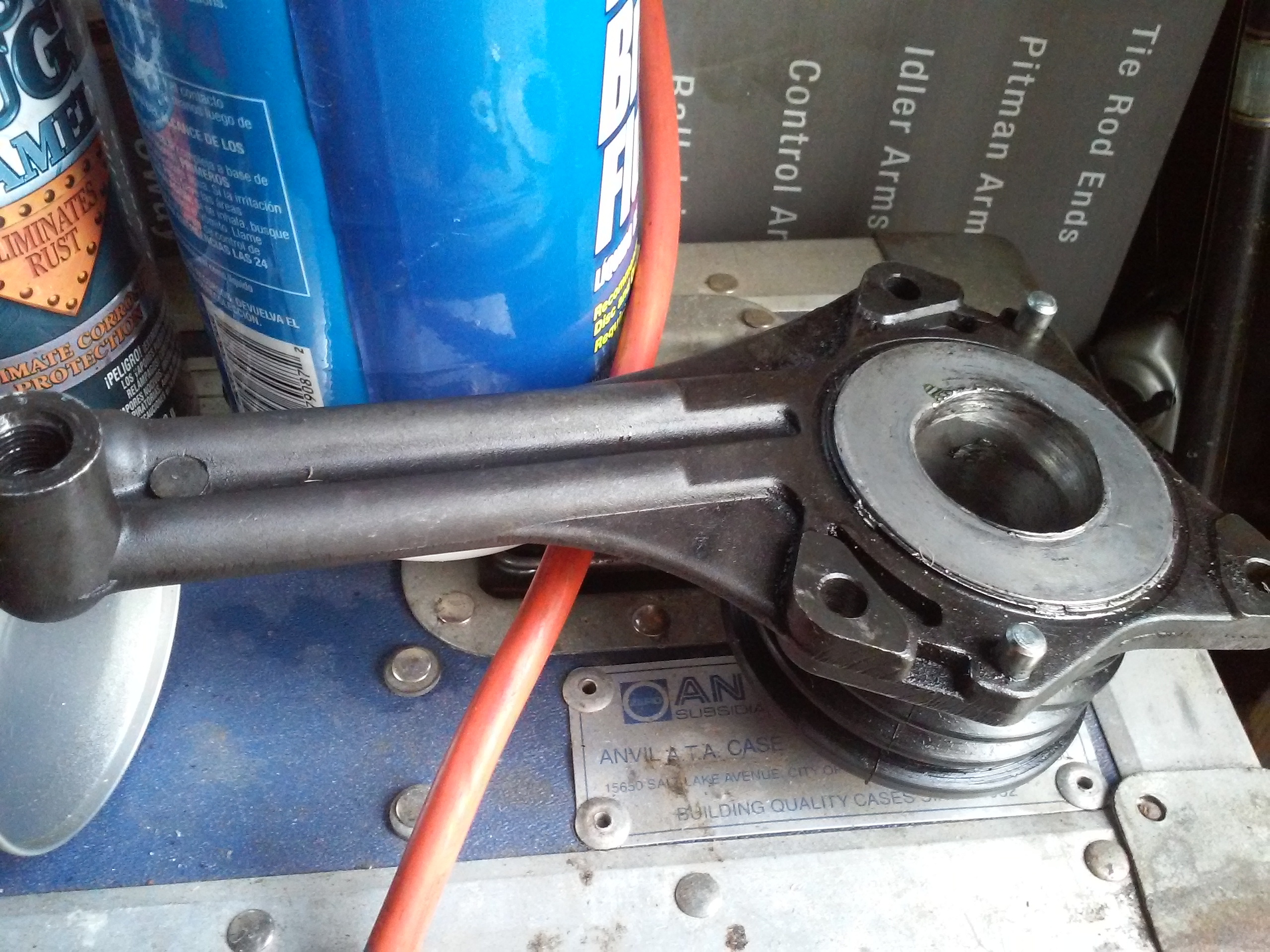

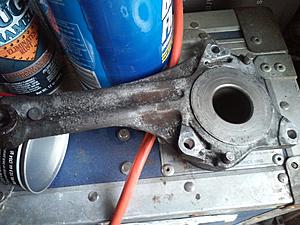

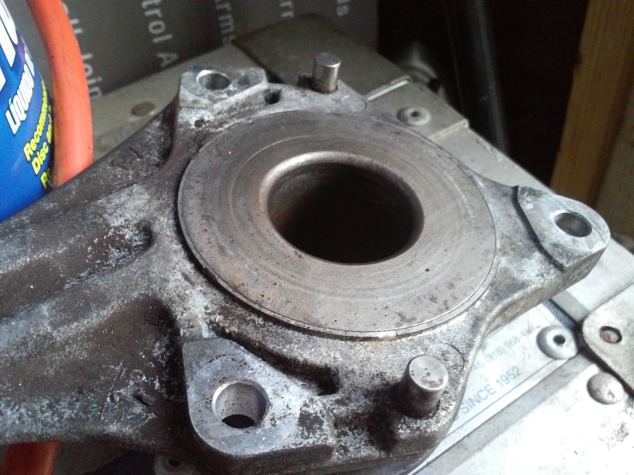

I recently replaced my old stock throwout bearing (2003 Mitsubishi Lancer OZ Rally) with a new oem one. The bearing was bad and it pretty much fixed the main noise problem I had. The thing is, is that after I finished the new install a different grinding noise came up. I was told the noise would go away but after a week it didn't. I bought a clutch kit and decided that the throwout bearing i initially installed was defective.
Again I replaced the throwout bearing, replaced the clutch, pressure, and aligned everything. Test drove it and the grinding noise is still there. Im not sure whats going on but on the initial throwout bearing that I installed, it had some strange worn marks inside the retaining tube where the input shaft comes through. I know I put the newest throwout bearing on straight but why does it still make the same grinding sound. How can I get this taken care of? Any comment will help.
Everything on the car runs great, clutch bites good, no slips, no grinds, gas hits good but that grinding noise worries me. (grinding noise is most noticeable after a cold start driving below 45mph, the noise evens out and goes away after 10-15mins.) My cousin says its just the 'breaking in' of the new parts but Im second guessing him. We also did all the installs via ground/floor jack and engine jack, tranny was lowered out.
Refer to photos to see the wear marks.

First of all, you're images are HUGE! normally that would be ok, but I'm in Europe right now, and the wifi in my hotel room is basically on par with dial up, so I only loaded the first image...
the wear on the release bearing(throw-out bearing)/slave cylinder I saw was very strange, since there should be zero contact/interaction between the release bearing and input shaft...it appears you may have some play in the input shaft.
can you post a picture of the inside of the bellhousing around the input shaft? it would beneficial to see what is causing the wear on the slave cylinder...surely there would be signs of damage on the transmission case, or input shaft, though the input shaft is made of a much harder metal, so perhaps not.

The tranny side of where the throwout bearing is attached has no wear, looks perfectly fine. I'm assuming that is is made of a much hard material, the wear only resulted in about 100 miles of driving too. I did drain the tranny fluid, it was almost a purple color a bit hazy. there was a good amount nearly 2 quarts.

something is contacting the bearing, unless the part is not correct, and mounts off center...
