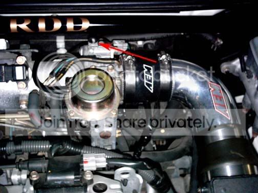

All I had to do was adjust a little bolt on the throttle body(not the one at the top that you can adjust with a flathead screwdriver). If anyone still needs to know how to fix this problem please reply. I will do a detailed rightup if there is at least one person with the problem still.

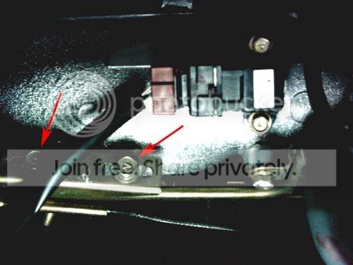

First loosen your throttle cable. For those of you who do not know how to loosen the cable, here you go. Loosen the throttle cable by loosening the bolts indicated in the picture. Push the metal piece to the right to increase the “slack” in the cable. There should be ample play in the cable now.

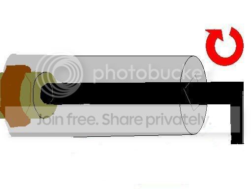

Using the ratchet and socket, loosen the indicated nut just enough so it can be turned by hand.
Use the hex key to turn the bolt counter clockwise and you will see/hear the rpm drop. The rpms should be at the TARGET RANGE(~600k when the radiator fan is off) and (~800k when the radiator fan is on)

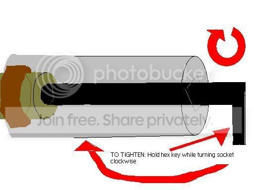

Now while holding the nut with the socket, insert the hex key into the bolt and slowly begin turning ONLY THE BOLT in a clockwise direction. Hold the socket to stop the nut from moving.
Keep turning the bolt just until you see/hear the rpms go up again. Now proceed to the next step.

Using the hex key, hold the bolt from turning while you hand tighten the nut using the socket. Now using the ratchet and socket, tighten the nut. The bolt may move while you do this so slightly turn the bolt counter-clockwise before tightening the nut. DO NOT OVERTIGHTEN.
If you have done this correctly, your rpms will now be in the target range. Now try to position your throttle cable as shown in the picture and retighten the bolts. DO NOT OVERTIGHTEN.
