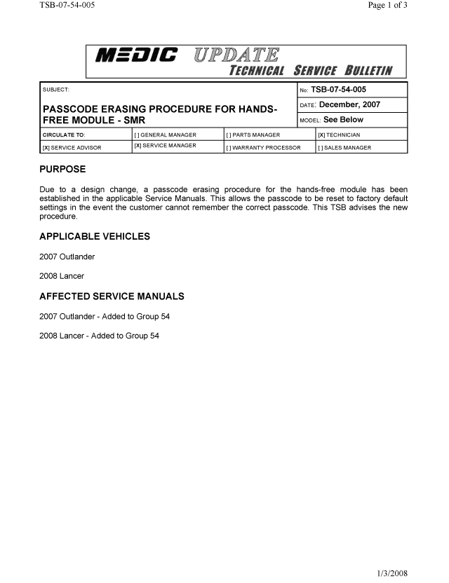

2008 Lancer TSB - Cell phone hands free passcode erasing procedure
TSB number 07-54-005
See images
