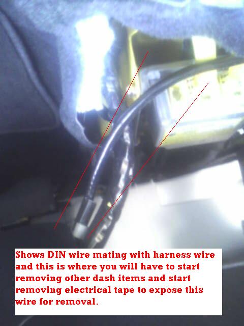

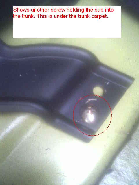

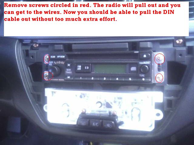

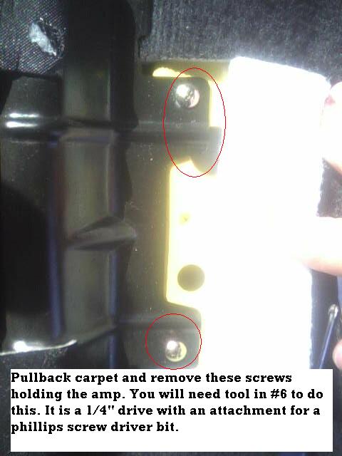

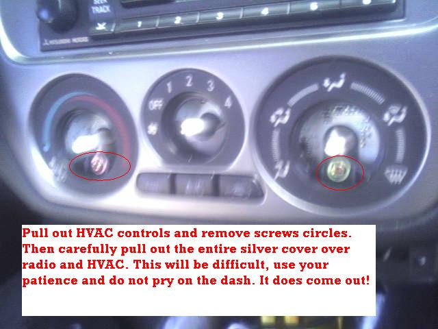

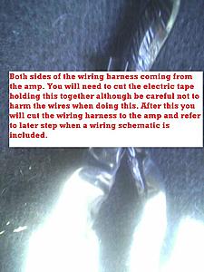

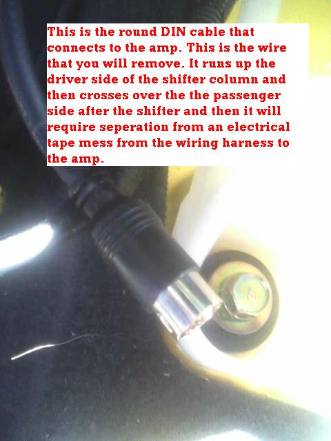

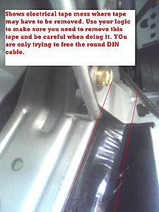

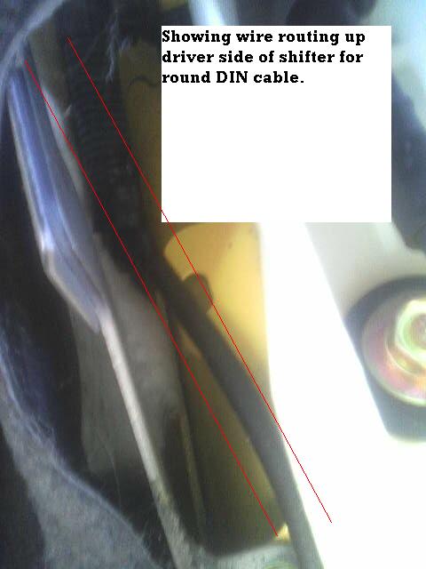

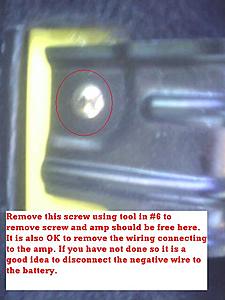

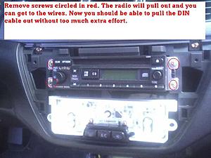

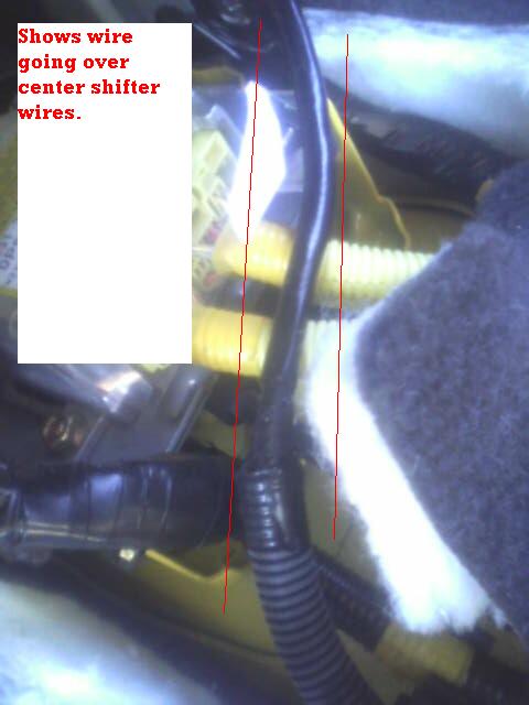

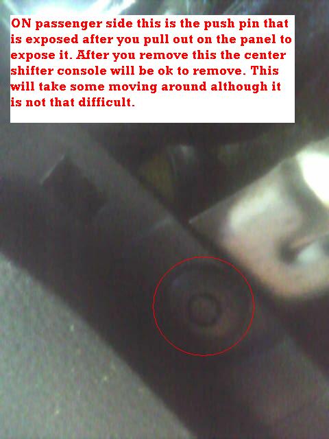

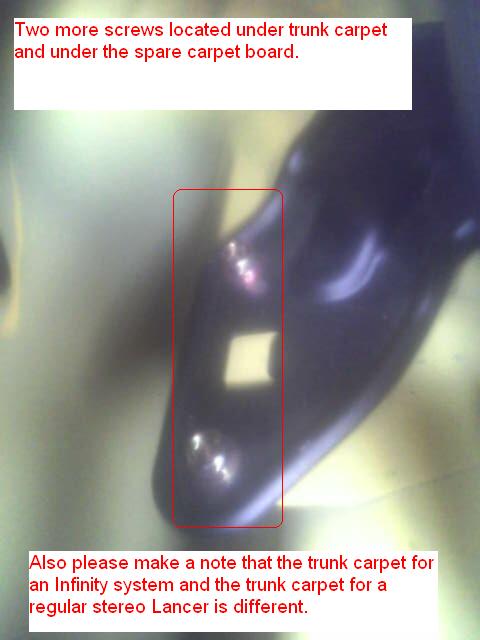

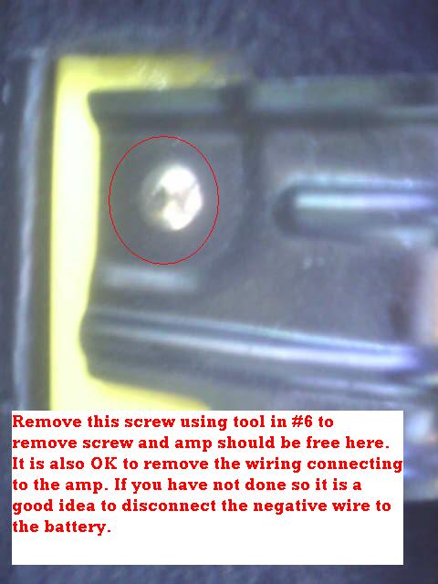

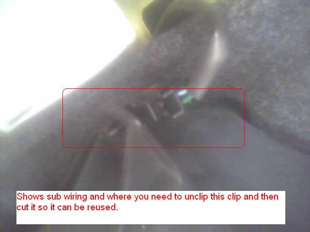

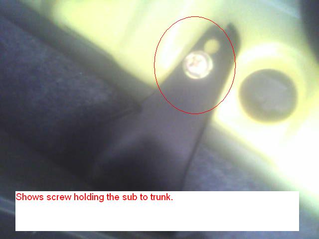

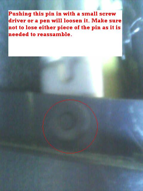

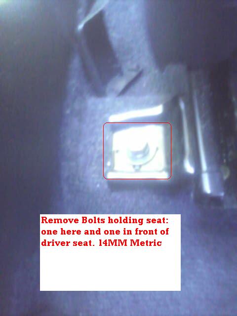

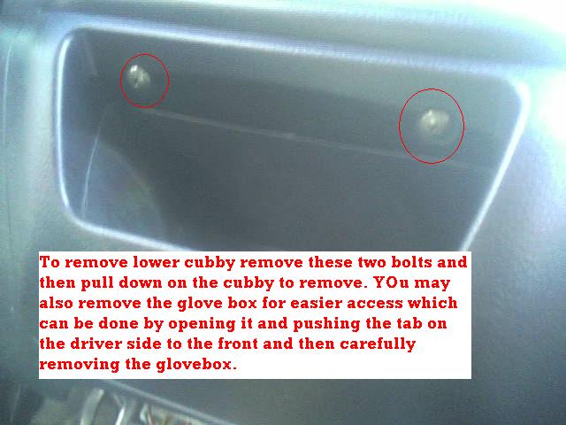

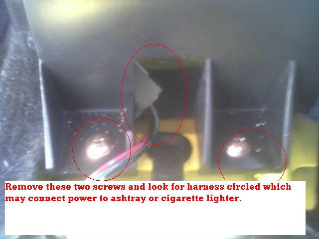

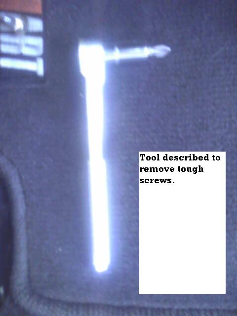

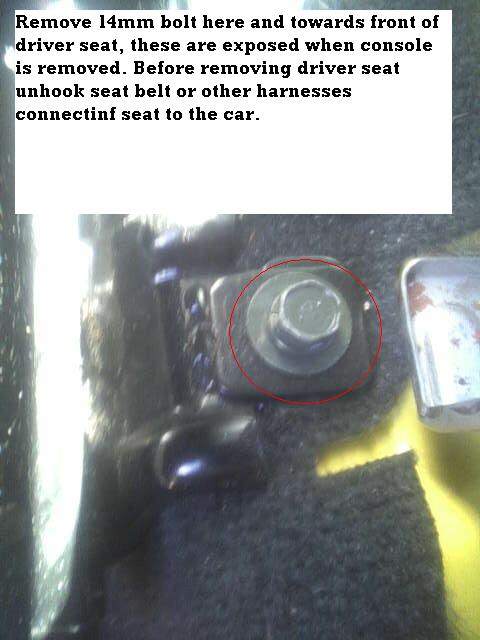

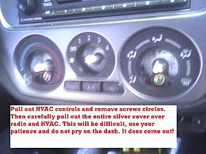

These pictures will describe in the best of my ability in how to remove the factory Infinity sound package from an EVO/Ralliart. I have more pictures to add and the descriptions could be a bit more detailed but this should show you 90% of the process.
Attached Thumbnails Removing factory Infinity System-1.jpg   Removing factory Infinity System-2.jpg   Removing factory Infinity System-3.jpg   Removing factory Infinity System-4.jpg   Removing factory Infinity System-5.jpg

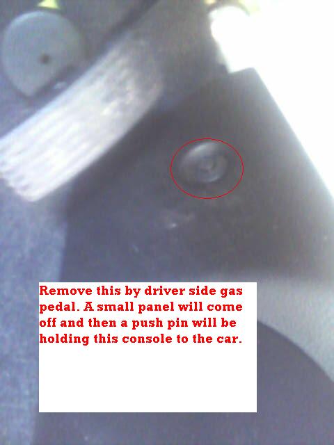

From: Anywhere

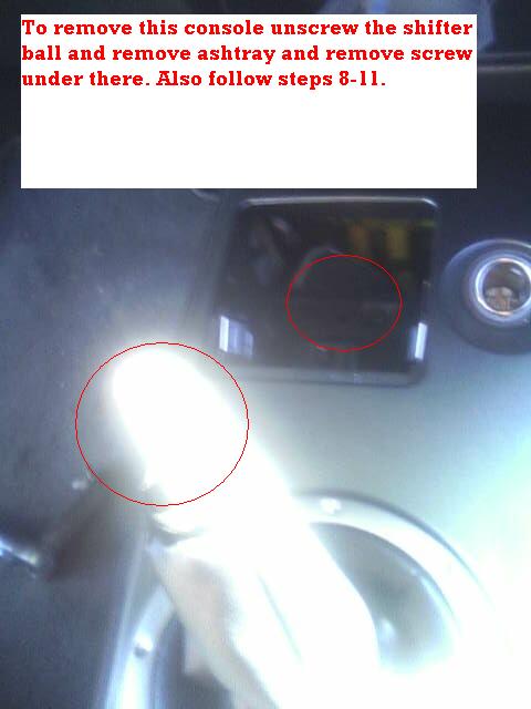

Attached Thumbnails Removing factory Infinity System-6.jpg   Removing factory Infinity System-7.jpg   Removing factory Infinity System-8.jpg   Removing factory Infinity System-9.jpg   Removing factory Infinity System-10.jpg

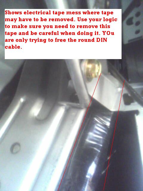

CORRECTION:
The Round DIN cable is seperate from the 18 pin wire that goes to the amp. The only time when this needs to be removed from tape is when it gets close to the radio.
Attached Thumbnails Removing factory Infinity System-11.jpg   Removing factory Infinity System-12.jpg   Removing factory Infinity System-13.jpg   Removing factory Infinity System-14.jpg   Removing factory Infinity System-15.jpg

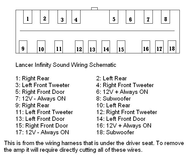

Here is the wiring schematic to under the driver seat. Please ask any and all questions. I did not test for positive and negative for the speakers as I have found that it typically doesn't matter unless speakers are wires in a series or parallel like multiple subwoofers.

From: Anywhere
Attached Thumbnails Removing factory Infinity System-21.jpg   Removing factory Infinity System-22.jpg   Removing factory Infinity System-23.jpg   Removing factory Infinity System-24.jpg   Removing factory Infinity System-25.jpg
