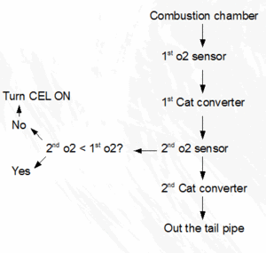

Hopefuly someone will correct me if I'm wrong.
The first o2 has pretty much nothing to do with the cat.
Exhaust exits the combustion chambers and enter the exhaust manifold
The first o2 takes a reading
The exhaust keeps flowing through the first cat and reaches the 2nd o2
The 2nd o2 takes a reading and compares it the first o2 reading to ensure the first cat is doing a good job.
The exhaust keeps on flowing through the second cat to clean the exhaust stream even more and out the tailpipe...
As you can see, the first o2 sensor has no clue what the emissions rules are, so even if your first cat was bad, the first o2 sensor wouldn't know the difference because the first o2 sensor only takes a sample reading and gets it compared to the second reading. The sencond o2 sensor will tell you if the first cat is bad.
There as got to be ways to test your o2 but I do not know them. Someone else will have to tell you how, or you may want to google it.
Attached Thumbnails Code P0421- Call Mitsu before you do anything!-simpleo2.gif
