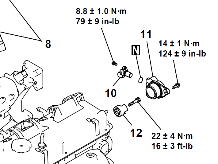

The camshaft position sensor is located on the driver side of the cylinder head as the diagram shows. The view in the diagram would be if you were standing by the driver side fender looking into the engine bay at the cylinder head. The sensor has one bolt that holds it in place.

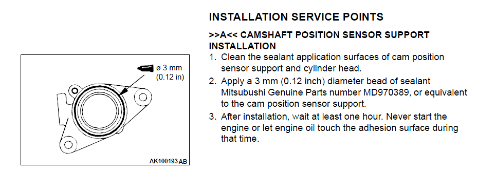

Alright senate. The code is a p0340 which is a camshaft position sensor circuit malfunction. Thank god for the tactrix cable. This must be the problem ive read about with the mirage head. Ive tried both the sensor from the mirage head and the sensor from the lancer head which I KNOW is good. So do you know what it is on the mirage head Im supposed to change? Cause its apparently not the sensor itself. The two cps are identical btw. Ill include pics if you want. The heads are completely identical in my eyes. I must be missing some small detail or something. Anyways, this makes things a little more hopeful in my eyes. And less costly.......I hope. Thank you senate.
Um I dont think thats right but I dont fully know yet so dont take my word on it. You guys ready for this? Check your heads when you get them from junkyards. I havent started my car yet so I dont know if this fixed it cause Im waiting for silicone to dry. I took off the end cap of the camshaft on the drivers side. The one the cam sensor bolts into? Well guess what? The little metal piece that goes on the end of the camshaft that the cam sensor reads was not on the camshaft. Like no bolt and no piece existed inside that housing. Who the hell would have ever expected that? Its like the junkyard took that piece for some god forsakenly unknown reason and covered it back up with that cap. Im assuming now that the worst I could have done was maybe fry a coil pack since there was no way that the car would have ever sparked without that piece in there therefore not ruining my ecu or the crank position sensor. I have taken the one off of my lancer and put it on there and am now waiting for the silicone seal to dry some before I try starting it. Im pretty sure though that everything will probably work out now though. Im sure im going to have some compression issues though. Thank you senate for all your advice and if you have any more to give, Im more than happy to hear it. Wish me luck.

I know. WTF right? The craziest part about it was that the original seal hadnt even been broken. Like the sensing piece was taken out and the cap was sealed back on. Lol. Anyways, the ecu is fried. I got it to start and its running on two cylinders. Both coils are good. The dead cylinders are two and three right now. But on the plus side it did start. Im going to get a pretty decent deal on an ecu here monday and get it all taken care of. But ya, thanks again senate for your help. Oh Btw, its ticking hella loudly. My timing is dead on though. I heard somewhere that the mirage cam was advanced six degrees? I have an adjustable cam gear and i can retard the timing if need be. Just curious. The only other thing I can think of is since I port matched my head, I soaked it down with carb cleaner and there wasnt a lick of oil on anything. When I added oil to my engine, I did so with the valve cover off and tried to make sure I soaked everything as thoroughly as possible then put the cover on. Maybe itll just take some time for the oil to work its way into the lifters or something? Any other suggestions? Thank you again.
