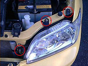

We all know those orange turn signal lights we have on the front headlights (see picture). I bought some replacement bulbs to take care of that problem. But my question is how the hell do I replace them? I took off the screws (see picture), but still wasn't able to remove the headlight.
I'm sure this is a really simple job, but I'm a complete newbie when it comes to things like this. Any help would be great! Thanks

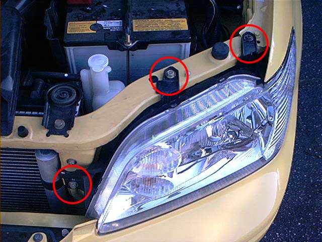

second picture

whoa whoa...no need to remove the dealihgt..read the manual...it tells u exaclty what to do

i havent replaced any bulbs in my headlights yet, but i doubt you have to take out the whole assembly. all u gotta do is dig your hand in your engine bay and turn the socket of the bulb counterclockwise. you could double check with your manual.. and before you do that, if you have two of those little nubs on your new bulbs, you gotta file one off so that you only have one nub to screw in or else it wont fit right.. someone correct me if im wrong, but thats what i've read and learned about..

all you have to do is twist the connection that goes to the bulb you want to remove, pull out the old bulb, put in the new one (don't touch the bulb itself of the new one), twist back on the connection.
